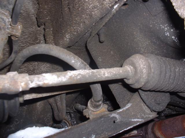

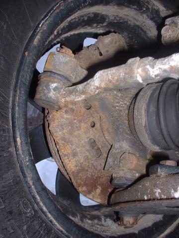

is this the "inner tie rod" connecting to the steering rack in the second picture???
any special tool required for this job???
