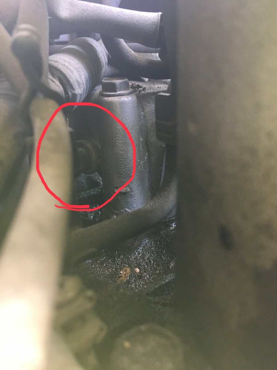

1997reduxe Posted June 7, 2019 Share Posted June 7, 2019 Can I unearth this thread? I’ve been having problems with my fans not working while I’m running AC, I have a 95 Legacy wagon 2.2 Also it’s been blowing out fuses for the Main Fan under dash in small fuse box. I connected the two green plugs together and replaced the fuse, and yes both fans turned on! my mechanic had said I needed a new fan. but my question is about the cooling sensor, which I assume is the culprit. WV above stated that he replaced his which had a brown plug on it. But when I look the sensor up, they have both a plug one and a tab one for connectors. and I see both on mine in that area. I have a pic below of what I think is my coolant one, but there is also what looks to be a faded brown one farther toward the engine interior. is This it? Quote Link to comment Share on other sites More sharing options...
FerGloyale Posted June 9, 2019 Share Posted June 9, 2019 the brown connector with 2 pins is the Coolant Temp Sensor that the ECU uses to determine engine temp/control fans. The single spade one is just for the Temp gauge. ECU doesn't see it. Quote Link to comment Share on other sites More sharing options...
el_freddo Posted June 9, 2019 Share Posted June 9, 2019 What I don’t understand about this issue (the 2009 one) is that the fans were NOT running and a new coolant temp sensor “fixed” it. If there’s an issue with the coolant temp sensor, or the circuit, the ECU runs the fans full time and the check engine light will illuminate. @1997reduxe - the best way to see the coolant temp sensor is from behind the intake manifold on the RHS of the engine. Cheers Bennie Quote Link to comment Share on other sites More sharing options...
1997reduxe Posted June 10, 2019 Share Posted June 10, 2019 Thank you both. after I posted the post I started fooling around with the diagnostic plugs. Thats something I never did, I guess I never had a reason. But I connected the green plugs and yes, the AC fan ran “strong” (for a 220k fan) and the sub fan ran, but very slowly. Then when I did it again later, the green plugs, it didn’t run at all. I found the AC fan a Dorman, and a four seasons sub fan both for 50 each. So I’m replacing both I’ll see what it does. The two sensors are probably a good option. But all those diagnostic plugs, that’s a whole new world to look into. Boy they put a lot into these cars. Quote Link to comment Share on other sites More sharing options...
