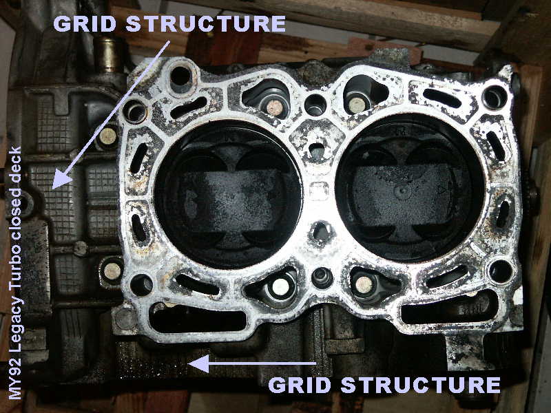

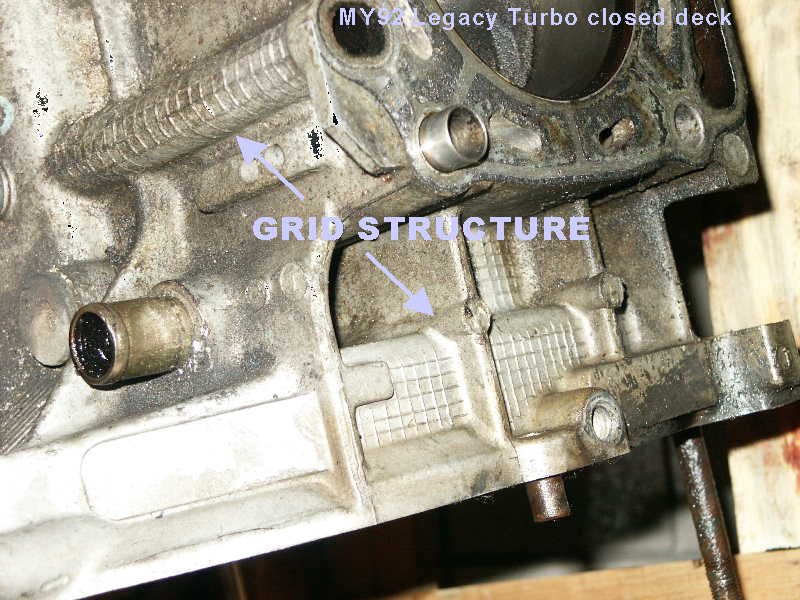

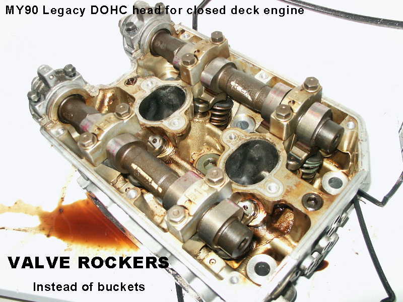

Marnix came through with pics.
Links:
Closed Deck 1
Closed Deck 2
Closed Deck Head
Open Deck 1
Open Deck 2

DO YOU KNOW WHAT JUST OCCURED TO ME?!?!??!?!
Sorry for the excitement....
BUT....the Legacy turbo block is closed deck. So is the EA82T. It is gridded, both of them like that....unless I am remembering something completely wrong. Are the EJ20G/K/7 gridded too? And a medium cast like the EJ22 turbo block?
If so...that means the EA82T engine is a medium cast. And 300 hp is realistic.....its just so detuned it not even funny.

I believe that materials are the same for all engines.
The EJ22 normally aspirated and I believe also the open deck EJ20G/K/5 are alle non-gridded. I wouldn't know about the EJ20H/R/7/9.
But sofar, the gridded / non-gridded castings show the difference between closed deck and open deck.
I think this stands as long as nobody proves this theory wrong.

Yesterday I finished putting the MY90 CD DOHC heads on a rebuilt MY92 OD EJ20 block. It's almost ready and supposed to go into the Wagon once I convert it to 4WD. Now that I also have bought an engine crane for only 50$ the games can commence!

look at Marnix's pic for open deck, then look at the ones for closed deck.
Also the grid pattern is a clue. Whether or not its a med. cast or high cast doesnt matter right now. Only SUBARU really knows what cast it is.
