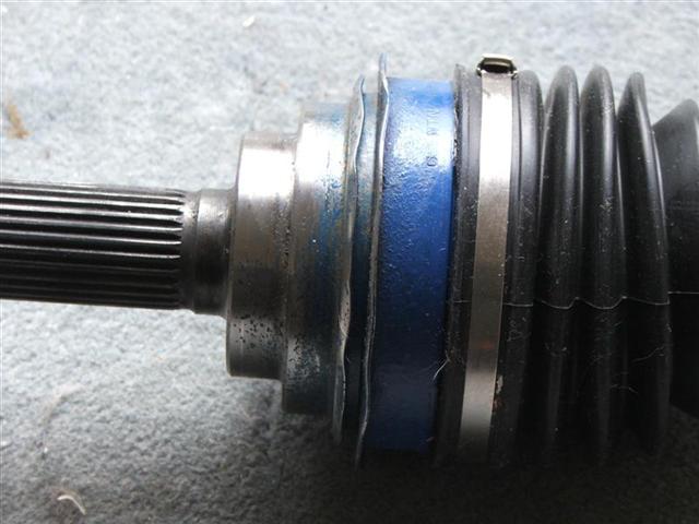

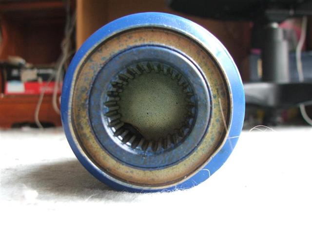

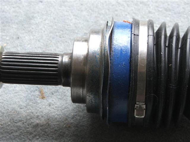

Ok, I just got my new (rebuilt) axle from MWE Axle's. Quick service and got what I needed. Problem is, some flanges on it are bent. I want to know if these ride against the seals or if they just keep crud out.
Here is what I am talking about.

Those bends in the dust shield are fine, just bend them back a hair so they don't scrape or drag.

Yah my MWE was like that too, I just bent them back. Yes I have had the easiest results undoing the strut to bearing housing bolts for axles.
