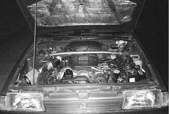

I have a question on how to shut off my four wheel drive? I heard i could just unplug something and the rear would just be dead. Can anyone help? It's just for fun in the snow:)

There's an empty fuse slot on the passenger side of the engine bay marked "FWD" Just put in one of the spare fuses from the fuse box.
