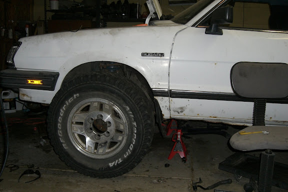

Woot for wheels!! Look what the Impreza brought home!
A tad bigger than what I want, but I'm getting rid of the rubber to mount up something 205/75 R15. Still looks pretty mean.
Ignore those pesky jack stands for the moment...

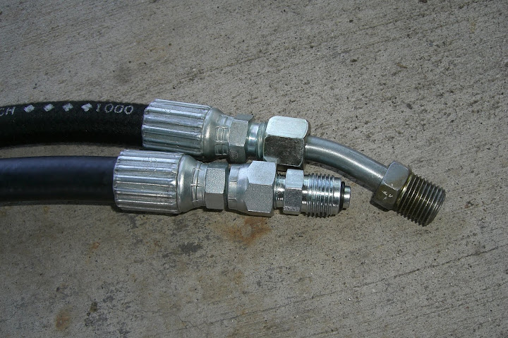

It was a good day on the brat. Got my hoses made at EVCO, got a 10" reversible aftermarket radiator fan from the junkyard that clips to the radiator itself, and my steering linkage all for $15. Here is the pics and info on the power steering system I went with.
Part list:
1 - 16MMBT-6MJ Bump Tube Adapter
1 - 10BS Metric Bite Sleeve
1 - 6G-10MDL Male DIN Light M16x1.5
1 - 6G-6FJX Female JIC Flare Swivel
1 - 6G-5MFA Male Flareless
3.5 ft - 6MGT Megatech 1000 (cool looking fabric coated cable*)
3.5 ft - 6M2T Hydraulic hose 100R16 4000 PSI
Total cost was $90.79

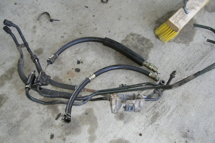

Old stuff... fittings were cannibalized due to lack of metric fittings available to me. Word to the wise, evco is lacking in the metric division. luckily I had all this so I was able to get the proper equipment.
Look at how pretty and clean it looks in comparison!
The metal tube end is a reused fitting, I don't remember the size exact, but I know it was a 17mm nut and is on the return line of the power steering as seen in the pic of the two hoses.
This is the other fittings. Taken from the high pressure side of the system, 14mm. There is only a fitting on the high pressure side because the return just clamps on. Hence the difference in hose type, The cool looking fabric one can me clamped on, while the rubber less cool looking one is better for the pressure.
