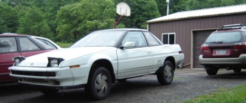

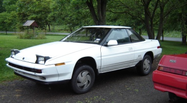

And I did grab some pic's of the lifted XT6. I also have a height switch, will install that shortly, and it'll look much better with the 06 Forester XT Turbo wheels.
