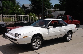

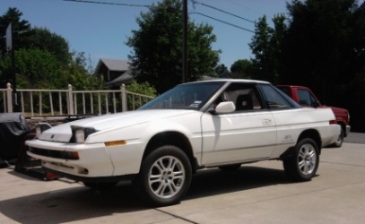

idosubaru Posted July 17, 2009 Share Posted July 17, 2009 XT6 with 2" lift and air suspension properly working now. Took some playing around and there's less freedom with the air suspension, but I got it to work and kept the air which is cool as I like it. Got another 1.25" from 05 Forester XT Turbo wheels. So far rides great, we'll see how it all holds up. Camera phone pics attached. Quote Link to comment Share on other sites More sharing options...
Turbone Posted July 17, 2009 Share Posted July 17, 2009 I think your going to need mudflaps Quote Link to comment Share on other sites More sharing options...

idosubaru Posted December 2, 2009 Author Share Posted December 2, 2009 (edited) Wow, only one response on this post?yeah, i know right? it's either me or the XT6, i can't figure it out So how is it holding up?holding up great, it's my daily driver. doesn't drive as nice and cush, but i guess that's the nature of a lift. i like the height right where it's at. drove it 4,000 miles to Colorado, towing a full 6x10 trailer, up a nutty mountain pass to 10,000 feet. that was pretty awesome. here's a picture most of the way up the pass: Edited December 2, 2009 by grossgary Quote Link to comment Share on other sites More sharing options...

idosubaru Posted April 5, 2010 Author Share Posted April 5, 2010 The moneypit is asking questions in PM's so here's the answers. EJ front strut extensions and EA rears. Have to be tweaked and drilled to accomodate the air lines if you're retaining the stock air suspension like I did. I used SJR stuff. The common 205 55/16" tires on WRX and all sorts of other 16" subaru rims fit with no problem. I'm currently running 215 60/16 (forester XT Turbo) and 225 55/16 (H6 OBW) tires and they fit as well but you have to bend the metal mud gaurd on the front air strut for those to clear or they'll rub. Just push them in by hand, real simple. Not sure how spring struts affect tire size, though it would only be different in the front, if at all. I like the extra clearance, visibility, and height for getting in out of the car without sacrificing handling like my truck which I don't like as a daily driver at all. Quote Link to comment Share on other sites More sharing options...
