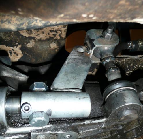

EA81 shifter slop is not really caused by the bushings, and frankly they rarely need replacement - I just grind 1/16" off the steel sleeve that sets how tight the two ears clamp down on the bushings to tighten them up a bit.
The issue, as s'ko pointed out, is the shift rod/sleeve interface. I have a been through a couple of fixes for this - my most recent is in this post:
http://www.ultimates...ead.php?t=86901
I recently had the opportunity to improve upon this method - I had to replace the 4 speed in my lifted wagon and during the process I decided to change to my "version 2" slop fix as outlined in my above post. I went the next level this time and installed a second locking bolt at a different angle - in this case I had already drilled the shift rod and sleeve for a 3/8" bolt several years back when I did one of my first "clamp style" version 1 slop fixes. Being already larger, I had to go with a 7/16 thread for the main bolt. I then drilled and tapped for a 5mm socket head cap screw at a different angle to help lock the sleeve from pivoting on the 7/16" bolt.
I have yet to drive the wagon with this installed as I'm building some new lift components for it, but it feels very solid and I used no new parts in the process. Just off-the-shelf components. I also removed a bit of metal from the bushing ear sleeve as I mentioned above to tighten the rubber bushings and I moved the pivot point of the shifter up by 3/4" to give the shifter a bit less throw and get back some height that it lost with the lift. You can see the where I cut and welded a section of steel rod into the pivot point and moved the shift rod/sleeve section down by the same amount.
Anyway - that's the version 3 slop fix as it sits now. I'll be able to fully evaluate it's performance after I'm able to drive it for a while. I'm planning to take it to the show this year.

I went from pure slop to an as new tightness, with this method.
A+ stuff.
