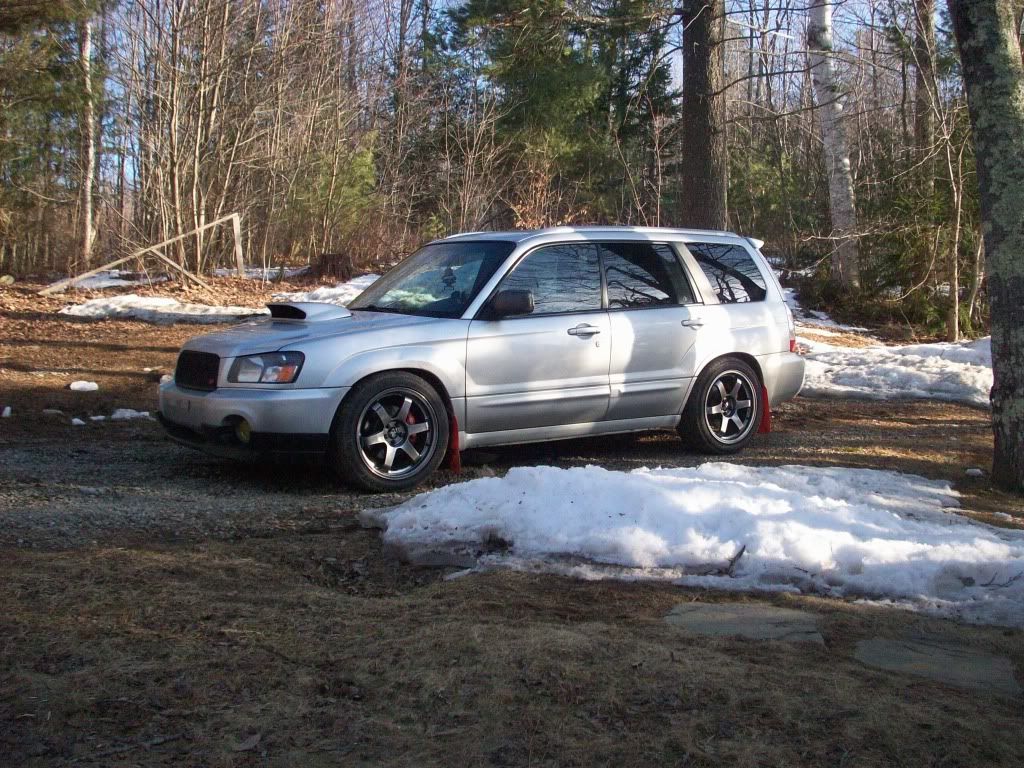

Ok a few more u18x8.5 Rota Grids for summer wheels and an Importology front lip
Posted Image

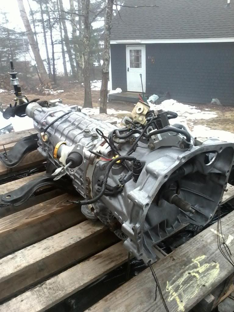

along with a few small odds and ends. The biggest new thing is an 04 STi 6 speed tranny with a Kartboy short shifter that will be going in soon!!
Posted Image
I will be using an Impreza auto driveshaft and Legacy turbo rear diff so I can keep my hubs with the 4 pot 2 pot brakes. And I will be using a DCCDPro to control the DCCD. I can't wait to get it in!!
