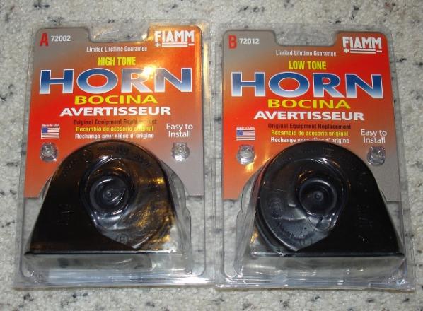

Getting ready to check the horn operation on my Brat, it is really puny. However, picked up a pair of Fiamm's (<$20) in case I need to replace the original ones. There are very few posts on the Fiamm's here. I have a new Bosch relay somewhere at home, and am prepared to use a relay for the horns, but will not if unnecessary. I have two questions:
  1. How do I remove the trapezoidal horn button (steering wheel trim button) to check the horn switch? Does it just pry off?
  2. Is the original circuit adequate for wiring up the pair of horns, or is a relay mandatory? I realize the horn is used on a momentary basis, hence questioning the need for a relay!

Horn button is removed by pulling the bottom edges toward you.
Getting it snapped back in-place is another story.... Grrrrr!
Original horns have both a power and ground wire going to them, so some wiring changes would be needed from relay to horns. Use Factory wiring to operate the relay, and a fused circuit to the horns.
Most of the issues I've had with horns has been corrosion at the horn(s) themselves.

Checked the horns out today. Unplugged both and rapped/slapped the fronts a few times. Connected both and reinstalled. They actually sound great. Hence, did not replace.
