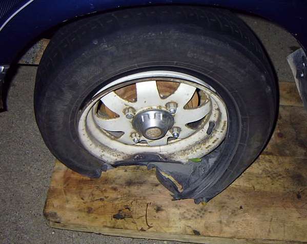

you totally cook the grease out of the bearings, and then you keep driving them... it locks up at 65 mph on the interstate... then you drive the car 1.5 miles to the next exit where you get towed back home....
  • Attached File  FLAT.JPG   35.91K   22 downloads
