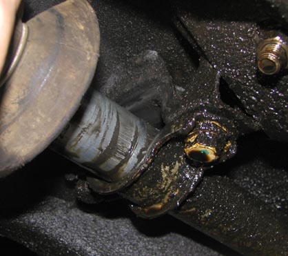

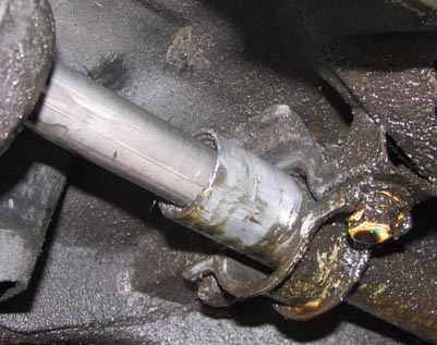

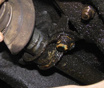

Lound rear end = lound front end (PICS)
seattlelegacy replied to seattlelegacy's topic in Old Gen.: 80's GL/DL/XT/Loyales...
Good advice, because I was worried about FUBARing my alignment. I'm almost certain the bushings come split, so it may not be necessay, and if its not, then I don't think I'll have to take anythign off. Just loosen those mounting brackets, slide them in and retighten. As for the axles, I was to understand that it could be done witout removing the sway bar or the control arm bolt, No??? Jordan -
Yeah, I was kind of pissed off when I saw it too. Its so loose in there, its like how the hell could you bolt that back together, and just walk (or drive) away knowing that thing is flopping around under there. Judging by the bushing I found online, It doesn't seem like something that would just fall off/out of there. I'm pretty sure the one I linked to is the correct bushing. The square bottom on the bushing probably faces up where the metal bracket is mounted over the steering rack end. Now the issue is that I have to take the tie rod end off when I do replace it, that that's going to be a PITA. Lucky for me I'll be doing the axle on that side anyway, so it will all get done at once. If anyone has a pic of pax side of the manual steering rack, I'd love to see it, although I suspect the boot will be tied on to the end of the rubber bushing, so no metal will be exposed. -
So, I'm a little slow. What I though was a loud rear end I'm guessing is probably just a loud front end. I know something is missing here, but after looking through the factory service manual I can't figure out if my rack needs to be replaced, or if this is repairable. What do you all think? (1984 GL wagon - EA81) I'm wondering if this part might fit in there somewhere: http://198.208.187.182/internet/PartImage.jsp?mfgname=ACDELCO&prodlinecd=45&acpartnbr=45G24014
