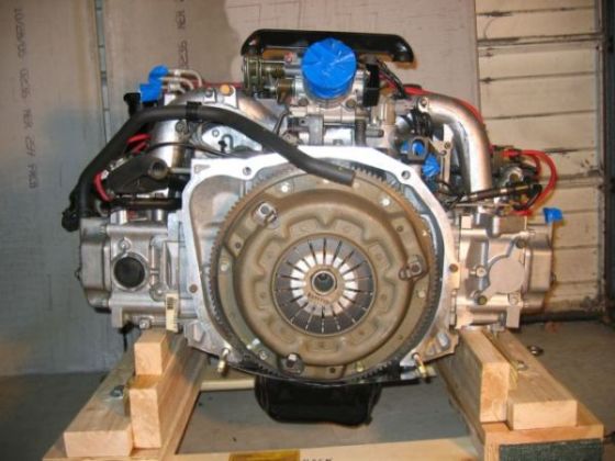

I am just starting my first conversion and am assembling the pieces. I have a clutch question. Most my questions will be very simple so please stay with me.... My NOS 2.2l engine has a brand new clutch installed on it. I assume that the clutch is matched to the engine. What I am try to determine is this - do I need to purchase a new clutch or is the one on the engine OK to use? I have a KEP adapter plate and flywheel on order. I know the clutch in my Westy is tired with 135k miles on it. I will purchase a new heavy duty VW clutch if this one on the Subaru engine will not work. I am attempting to attached is a picture of the clutch. Any thoughts? Thanks.
