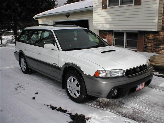

My '98 Outback
kenfb1 replied to kenfb1's topic in 1990 to Present Legacy, Impreza, Outback, Forester, Baja, WRX&WrxSTI, SVXSo far, so good in the snow this year. We had two pretty good storms so far and I haven't spun the wheels at all yet, even going up some pretty good hills around here. I bought a tire and wheel package from tirerack.com this year. I got Kumho 205/70-15in winter tires, oem 15in steel wheels and the wheel covers for a little over $400 delivered and ready to mount. I think this was a great investment. My stock alum. wheels are nice and safe in my garage and as a bonus I use one of them as my full size spare if needed. Even if I only get two years out of the winter tires I think it's worth it. The tires were only $45 each!! Ken
