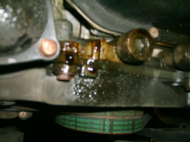

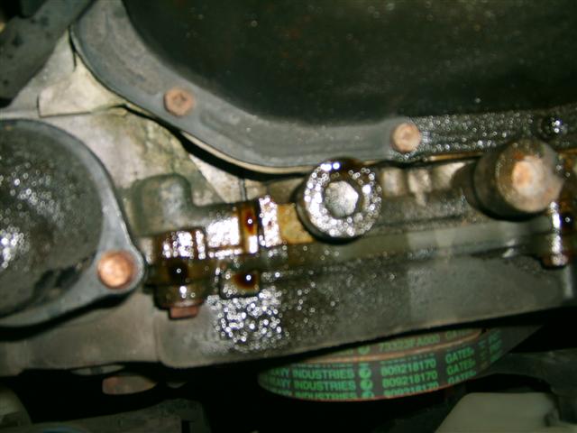

TurboTbird replied to TurboTbird's topic in 1990 to Present Legacy, Impreza, Outback, Forester, Baja, WRX&WrxSTI, SVXI'm ordering Felpro Crank seal, cams seals, a goodyear timing belt, and a timing cover seal. Where do I get an oil pump seal? I cant find one. Anything else I need? I'm not doing the water pump yet. I'm ordering from advance auto parts. Thanks

TurboTbird replied to TurboTbird's topic in 1990 to Present Legacy, Impreza, Outback, Forester, Baja, WRX&WrxSTI, SVXI get the sarcasm, I've heard the FRAM horror stories, but I haven't had any problems. Thanks for all your help, looks like the subie is gonna get some TLC this week.

Hey everyone, haven't been around much, the legacy has been doing good. It just hit 70K (on a 95) and is running great. Just got some new tires and NGK V-powers, and have been running Mobil 1 in it. I have discovered an oil leak under the front crank pulley. I took some pictures of it, if someone could give me a good guess of what it could be it would be greatly appreciated. Thanks.
