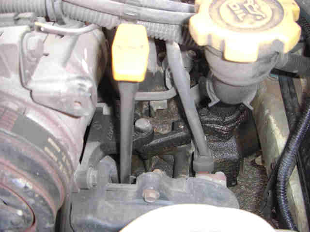

well i'm not sure what a sensor is supposed to look like when it goes bad but the contacts on both ends look sparkling clean, the wires had no breaks. I didnt take it off, just unplugged it as i didnt have a replacement to put on. we replaced the fuel filter and air filter. i've attached some pictures showing how oiled up the drivers side of my engine is. we're going to power wash it off another day and check later to see where the mess is coming from
