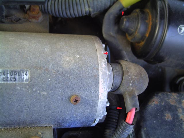

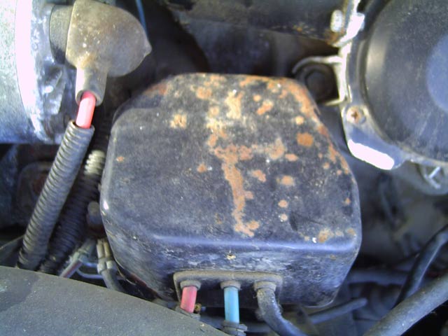

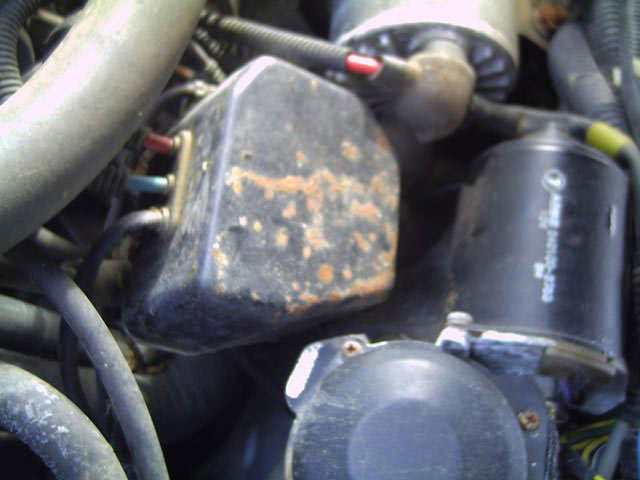

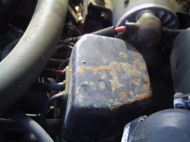

Not sure if these pics will help...I didn't check the terminus of the small blue wire except that one end goes into a wire loom headed toward the drivers side firewall and the other headed towards the passengers side fenderwell. I will have to check closer tomorrow when I am at work where the car is stored.
