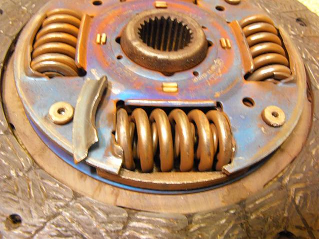

Yep, the mystery of the on/off clutch has been solved. As per the attached picture, a small bit of the clutch plate had broken off and would sometimes get jammed between the clutch plate and the flywheel, keeping them spinning even though I was pushing the clutch in. Makes sense now why it wouldn't go into gear. (Why it didn't go into gear even with the engine off the first two times it happened I still don't know: wind up in the gearbox maybe?) It jammed again at the worst possible moment: as I was moving houses. So I dumped the car, only to get a call from a worker saying I had to move it as they were doing roadworks there the next day. :mad: Tow truck took it to the mechanic who couldn't fault it! I told him to open the clutch to have a look and there it was. $800 later it's all fixed and feels great. Thank you all for the input, it's been much appreciated.
