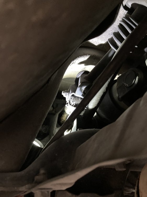

  13. Can I unearth this thread? I’ve been having problems with my fans not working while I’m running AC, I have a 95 Legacy wagon 2.2 Also it’s been blowing out fuses for the Main Fan under dash in small fuse box. I connected the two green plugs together and replaced the fuse, and yes both fans turned on! my mechanic had said I needed a new fan. but my question is about the cooling sensor, which I assume is the culprit. WV above stated that he replaced his which had a brown plug on it. But when I look the sensor up, they have both a plug one and a tab one for connectors. and I see both on mine in that area. I have a pic below of what I think is my coolant one, but there is also what looks to be a faded brown one farther toward the engine interior. is This it?
