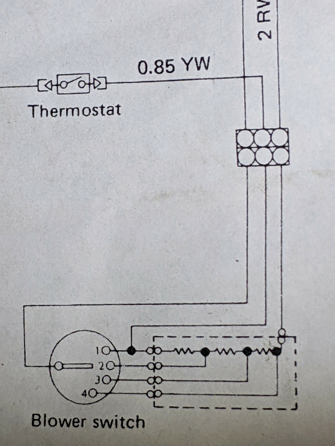

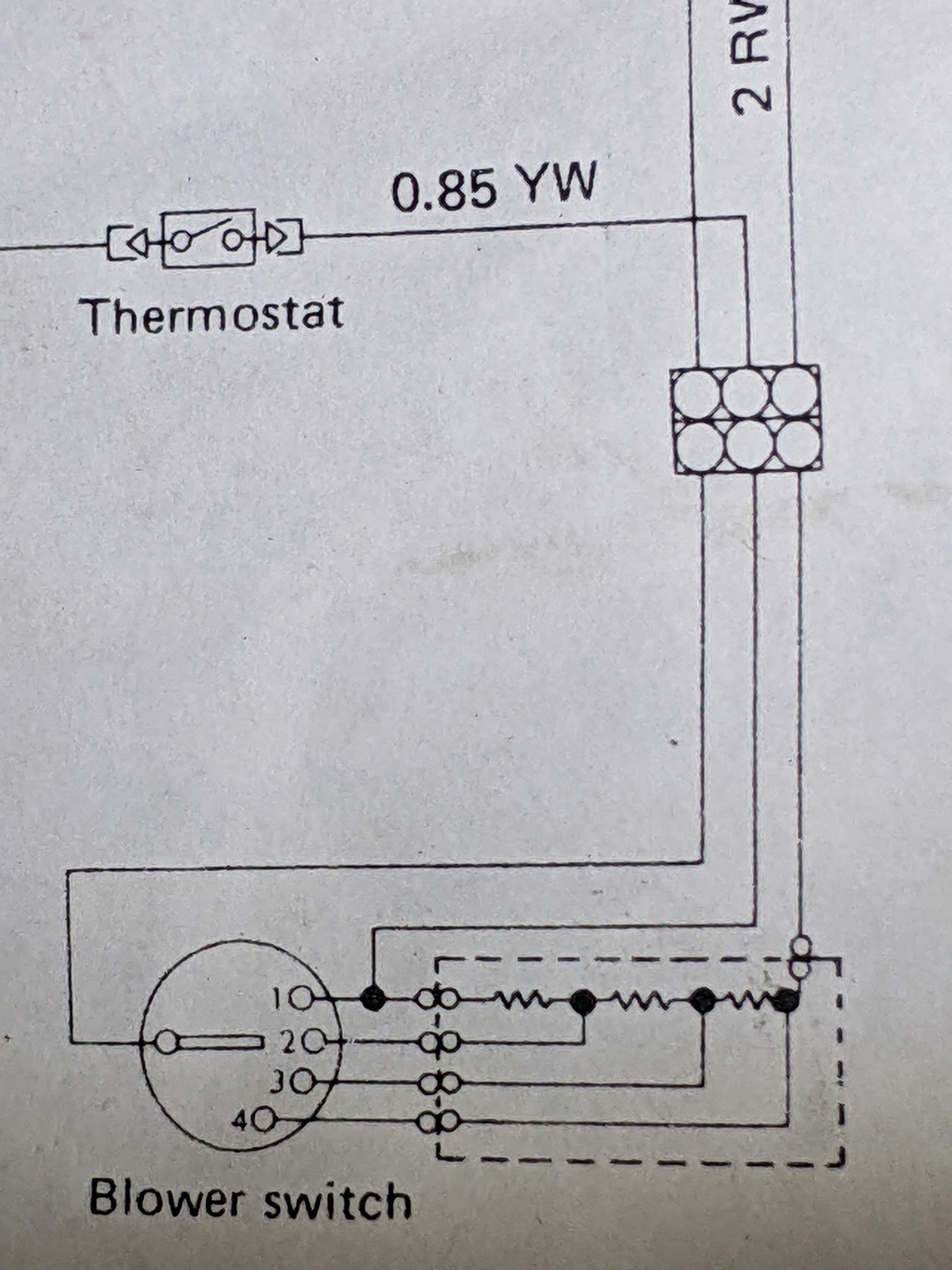

85 BRAT, where is AC thermostat? Wiring Diagram pic
mkoch replied to mkoch's topic in Old Gen.: 80's GL/DL/XT/Loyales...
With the battery disconnected, I tested the resistance from the AC relay, through the thermostat and fan speed switch, to ground. You're right! The thermostat is part of the circuit in the four fan speed positions. Thank you for the response! -
