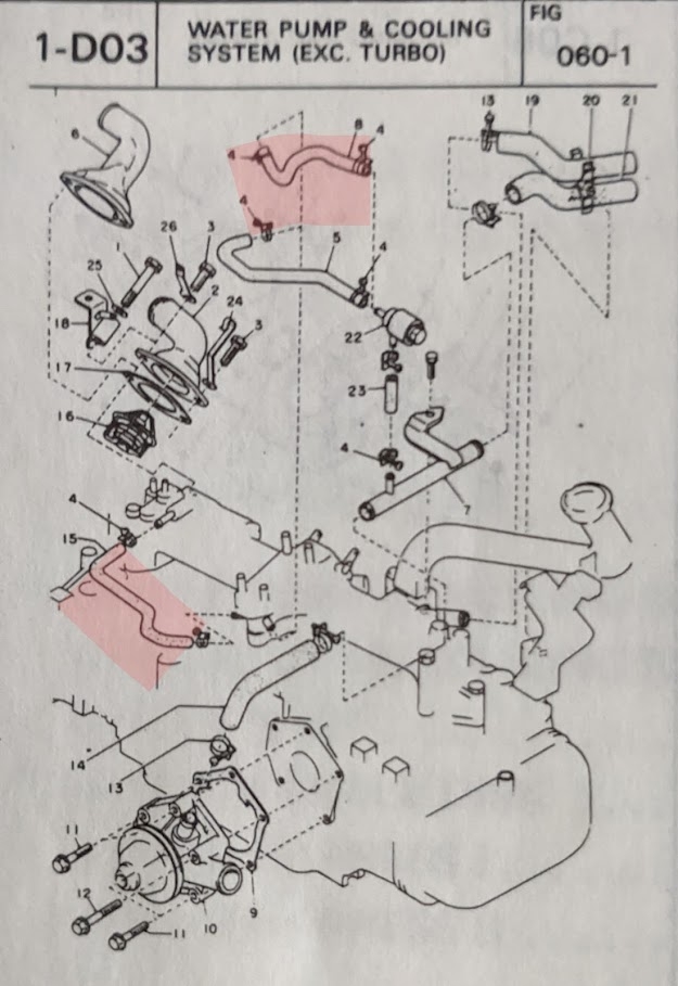

  4. I am sure the leak is not coming from the two hoses highlighted in the image. Is the center of the intake manifold connected to the engine coolant?

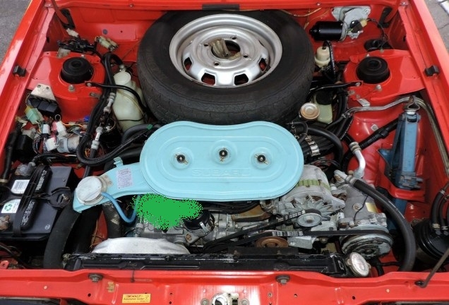

  5. A steaming cloud of coolant was emanating from under my air filter cover, passenger side, this evening!! See photo for an approximation of what it looked like. Coolant represented in green. What is the most likely source of the leak?
