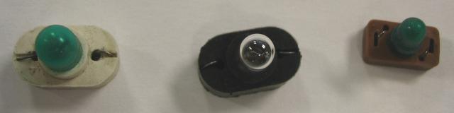

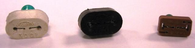

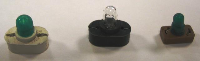

I am looking for some help finding replacement bulbs for the instrument panel in my '88 GL10 Turbo with the Digidash. There are four bulbs on the perimeter that light up the instrument panel and the two at the bottom around the odometer and the trip mileage counter are burned out. They look like the white and black based bulbs below (the brown one is the back light for the rear wiper/washer switch, also burned out). The bulbs are not the standard 1/4 turn bulbs that you can get at Napa and my local Subaru dealer wants $11 for one bulb plus he can't get them until the end of February. Anyone have any suggestions? Thanks.
