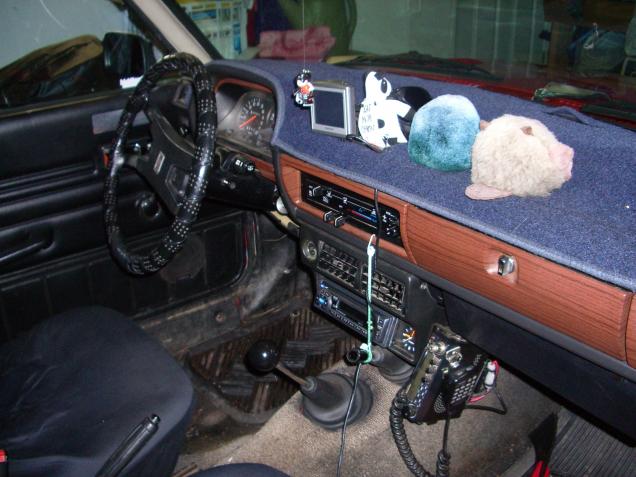

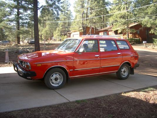

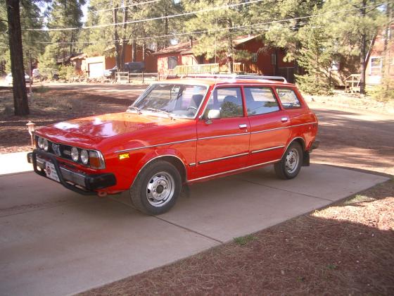

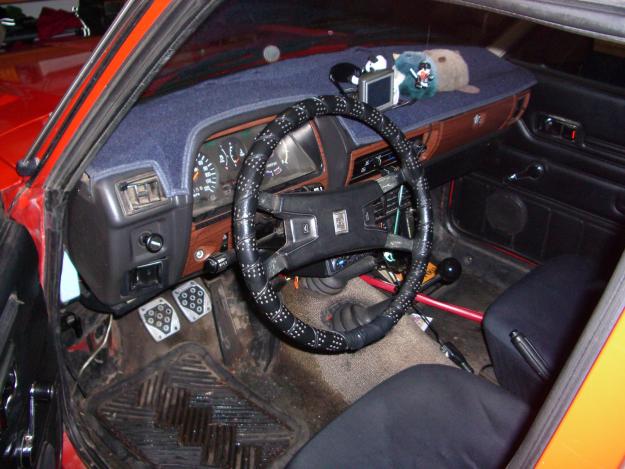

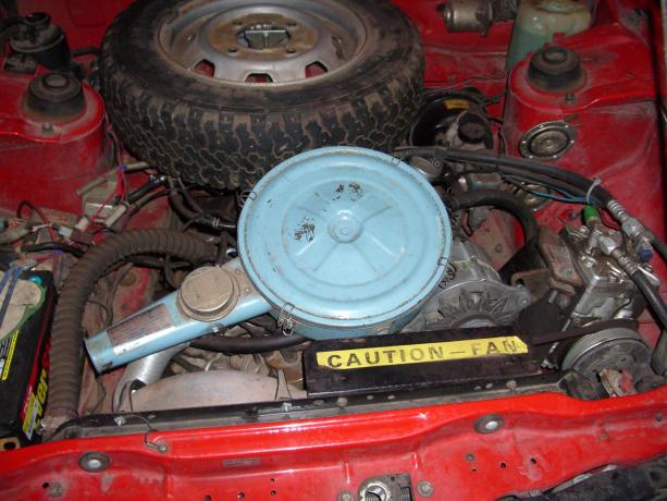

Here is my 1979 GL 1600 Wagon. All Subaru except for the Stereo added before I bought her. Paint is the original "Brilliant Red" and the interior is stock from the factory. The Driver's seat has much wear and that's a project for this Summer. Engine rebuild is coming this Summer as well.
