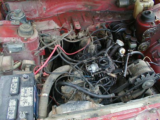

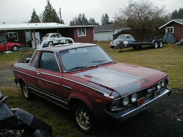

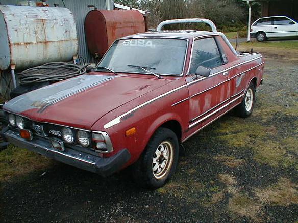

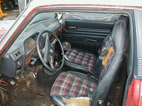

I finally took some pictures of my 79 Gen1 Brat and now have "Post Attachment Priv.". So I will post them here. Pretty Rough (well more "Rough" than pretty). Really bad fender Bad dent behind door post. Interior trashed but has OEM radio and clock. Many off engine components missing. Runs but won't idle (I wonder why?) [ATTACH]7196[/ATTACH] Scored two spare engines. Tailgate is good but missing latch handle. Steve
