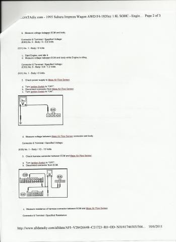

travis1990 replied to travis1990's topic in 1990 to Present Legacy, Impreza, Outback, Forester, Baja, WRX&WrxSTI, SVXOk, here's a little update. The plugs I were looking for were the ones that go into the ECU. I got my multimeter out with the intent of checking the resistance of the wires going from the ECU to the mass airflow sensor to make sure it was within factory spec (less than 10ohms). Turns out I couldn't get continuity on one of the wires going from the ECU to the mass airflow sensor. Do you think I should run a new wire up to the mass airflow sensor from the ECU?
My new Impreza Outback

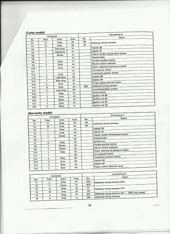

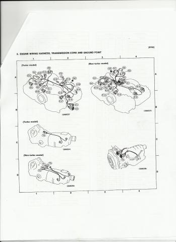

travis1990 replied to travis1990's topic in 1990 to Present Legacy, Impreza, Outback, Forester, Baja, WRX&WrxSTI, SVXSo, where are connectors E25,E30, and E31 located? I need to know so I can do the diagnostic procedure outlined in the factory service manual.
travis1990 replied to travis1990's topic in 1990 to Present Legacy, Impreza, Outback, Forester, Baja, WRX&WrxSTI, SVXMy alldata manual shows plugs called E25,E30, and E31, but the FSM dosen't show those plugs. Where are they? Also, where is the CTS? It's supposed to be E5 on the last picture, but I couldn't find it on the car.
