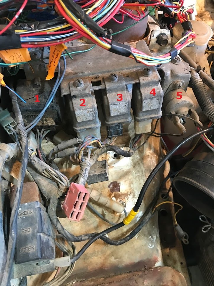

  5. Can anyone tell me what these numbered items are? This is the passenger side strut in an 82 Brat. They are taking up prime real estate for my EJ swap air box, and if I know what they do I can just remove them or relocate them as appropriate. I have a factory service manual for a 1983 but I either am not reading it correctly or there were some changes from 1982. Thanks!
