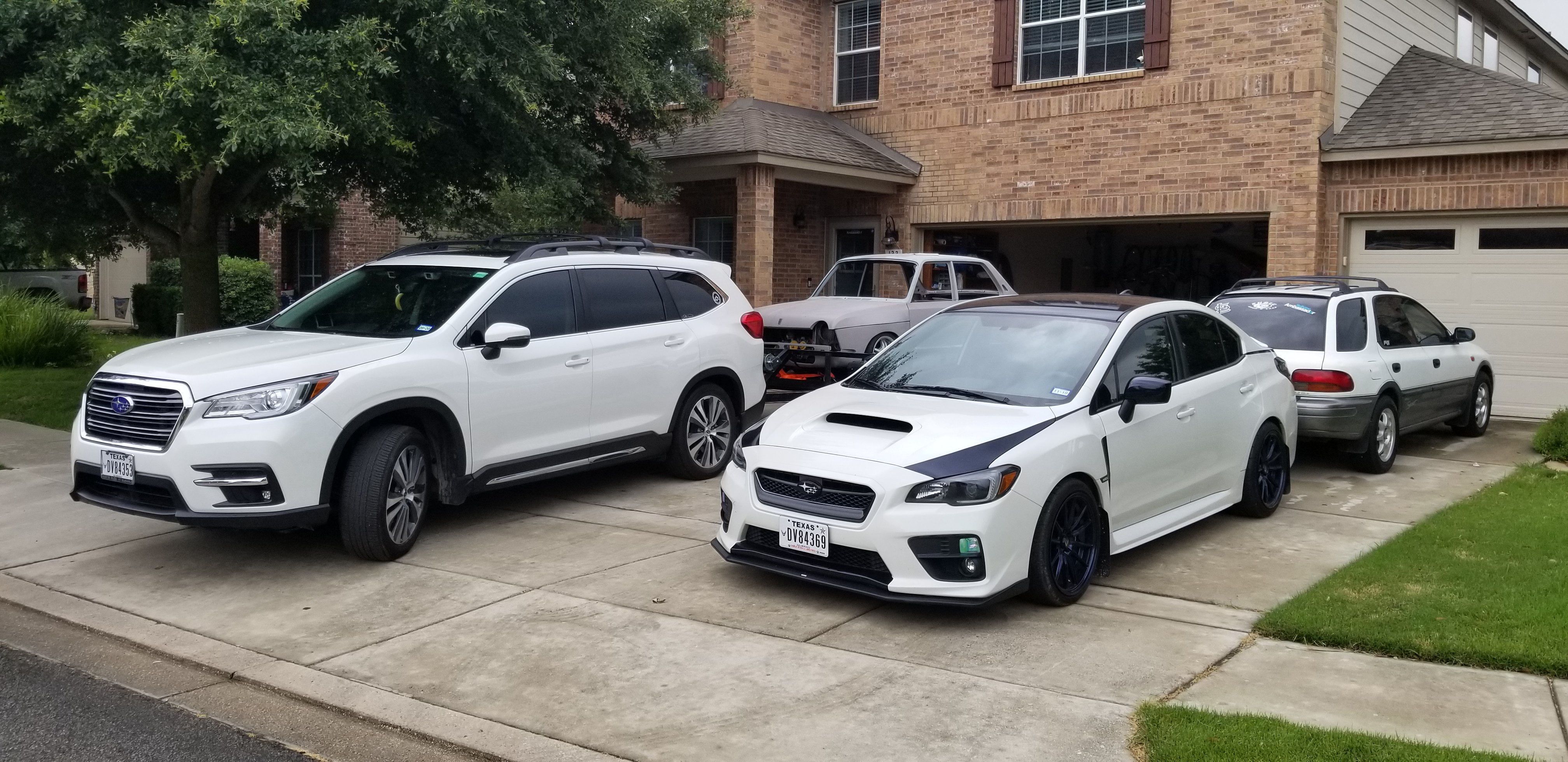

Sorry for the lack of posts on the website lately.. Frankly havent even logged on in quite some time. The build is idle at the moment has been for a little over 8 months now, unfortunately... I got reassigned new job and all (in the Air Force) and have been trying to get the family situated before jumping elbow deep in the car again. Hopefully this winter I can get the body work completely finished up. Here is a picture of what she looked like when I loaded it on the trailer to move up to Indiana. As you can see I have gone pretty extensive on the build...
