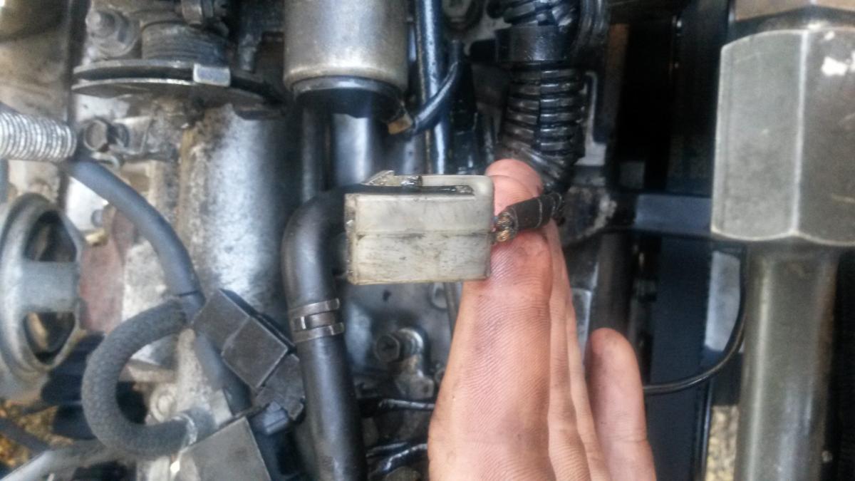

what does this connect to?
wakingtowinter replied to wakingtowinter's topic in Old Gen.: 80's GL/DL/XT/Loyales...
I ended up figuring it out. It is the solenoid valve that hooks up to the throttle body and EGR valve. -
