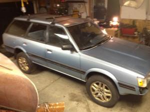

    The car is still running good. 122,000 original miles on the car probably 140 on the engine. I am thinking about selling her for some space in my woodshop. If you know anyone interested let me know.

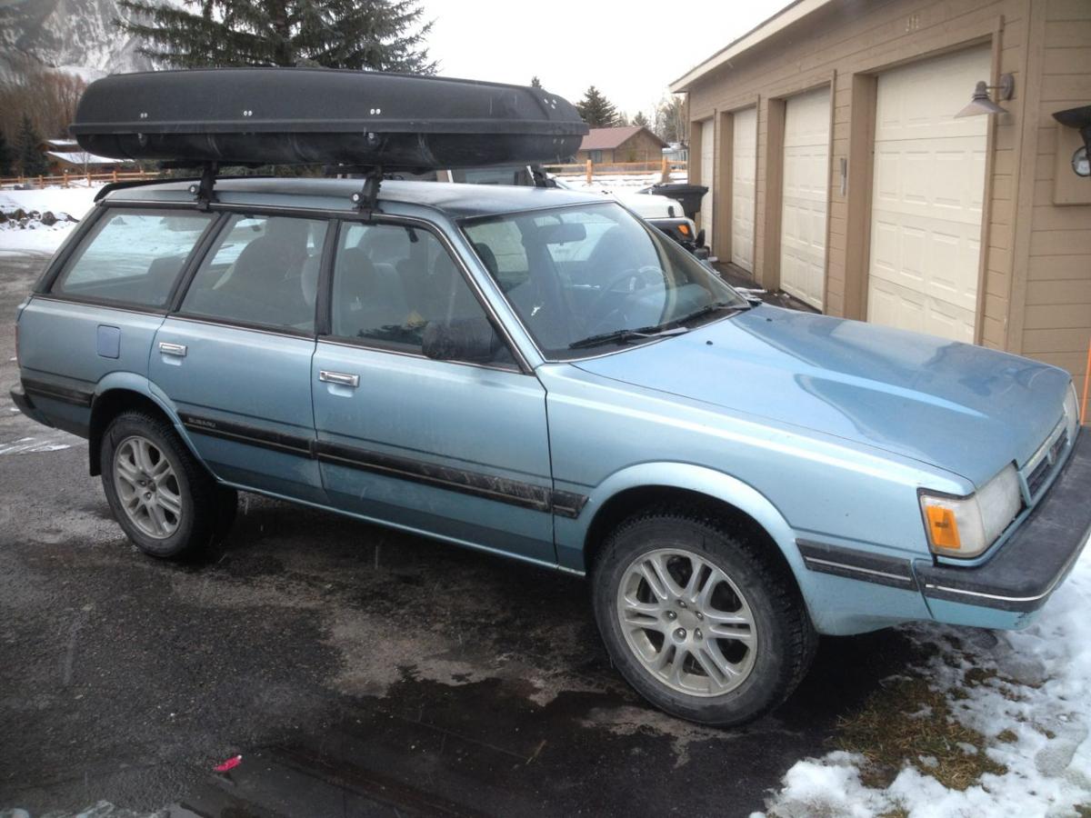

    1989 gl 2.2ej 2"in lift

    35,000 miles and counting. Just put in a spec stage 3 clutch replaced broken clutch fork new bearings and finally hooked up the oil pressure sending unit. Keep blowing out passenger cv boots. With just impreza struts and outback springs in the front. No extra lift. Just started to get some rust on the body panels.

    215/60/16 nitto snow on xt turbo wheels. boss 2 in in rear and imreza struts in front 1-1.25''?

    2in boss in the rear, Impreza struts in front about 1.5 in over stock 16 xt turbo wheels 215 60 16 nitto studless snow tires
