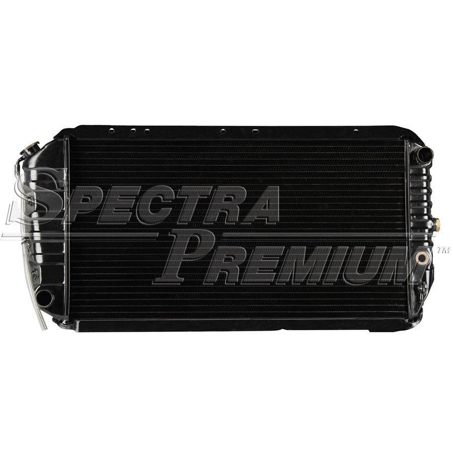

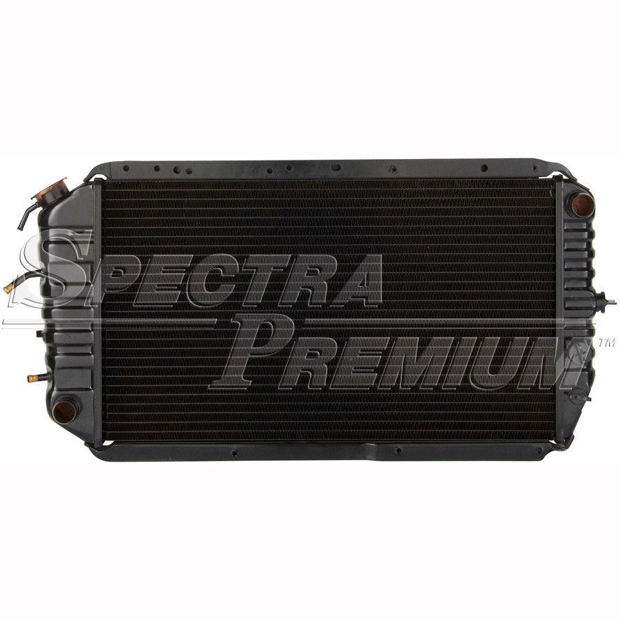

thanks for your replies jono and subruise. I've been thinking though, couldn't i just use these two pipes for an aftermarket oil cooler? I think what i may do though is just get the right radiator and sell this one at a good price here. I could've returned it, but i cut that overflow hose. DOH! (it's still welded up though- so it would be ok to use in an E82) I thought it funny that my radiator just had that radiator hose and no overflow tank, but upon searching I found that it was made that way. The E81 was vent to atmosphere- the radiator sort of works as it's own overflow tank and spits out what isn't needed. The driver needs to keep an eye on it and top up when needed. Keeping a bottle of some sort to collect the green juice would be smart though. -
As the title states, can I do it? I should've checked before buying it on Amazon. Amazon had said it fit my Brat, but I now see the difference. I have a E81 '85 Brat The Spectra CU698 has the two pipes on the rad. cap side which I believe would be for the overflow tank on an E82. The overflow hose is also welded and crimped- I had cut off a 1/4" of it and had seen it was welded. I could cut off a little more and use it as a overflow hose though as it's not filled completely. The Spectra CU698 also has a proper plug on the right side, but i should be able to fit a metal plug and washer -right now it just has a plastic plug in it similar to the drain. The fan fits though, and it lines up where it should with the two radiator bolts. Can i just take the radiator to a shop and have the two pipes for the overflow tank brazed/welded up? I should of ordered the Spectra CU84
