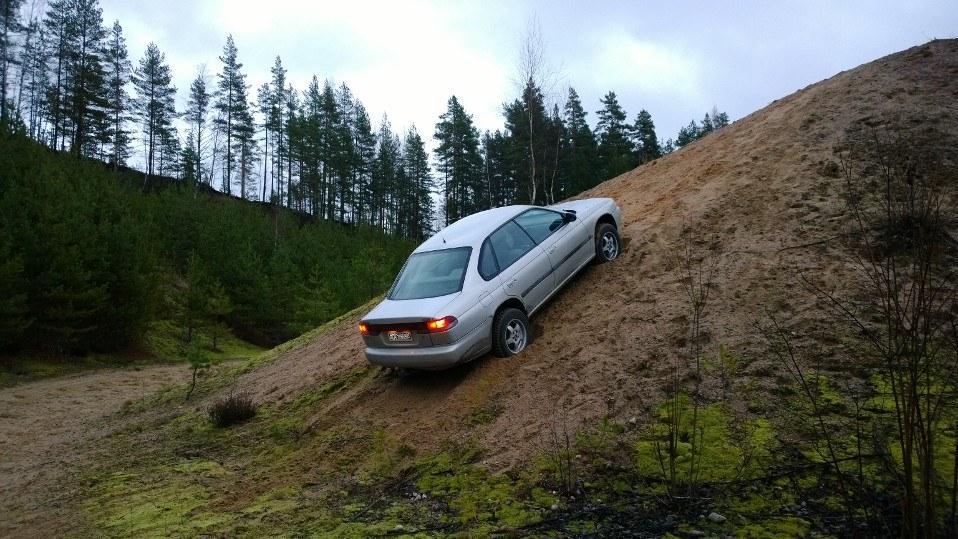

Newbie here. I have 1996 Legacy AWD with natural aspirated EJ20 and manual transmission. Home made 69mm (2.7")
lift kit and 205/70 R 15 studded tires, because it´s only used as winter. Future mods to come are dual range tranny from
my spare parts Legacy STW. And perhaps 1.19 to 1.59 dual range mod to that tranny.
Now it have 3.9:1 diff ratio and that will be changed to 4.11:1 during the transmission swap.
