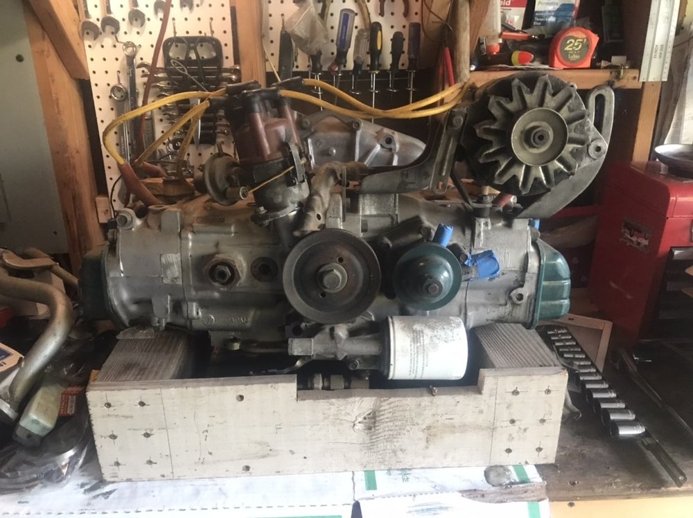

EA81 engine install
Olyroller83GL replied to Olyroller83GL's topic in Old Gen.: 80's GL/DL/XT/Loyales...
The engine was stored without the intake manifold and there is Almost no rust or corrosion anywhere. The previous owner said he squirted some oil on the cylinders a couple decades back to keep rust down. Should I stick with 10w-30 or maybe use a detergent type oil for the first 1000 miles? -
My 83 GL threw a rod and I picked up an EA81 just like the one that finally quit on me. It has 50,000 original miles on it but it has been in a barn for 25 years. My question is, besides resealing it and replacing everything rubber what else would I need to do to get this motor back in action? Should I replace the components with the ones that were in service a few weeks ago? That’s the original alternator I’d like to use it. Thanks
