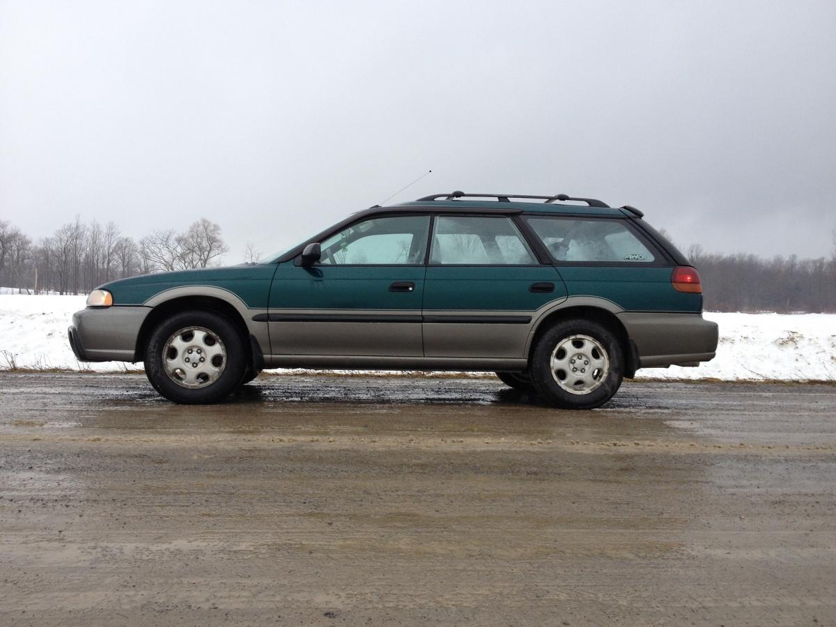

What she looks like now! After a bit of maintenance (brakes, spark plugs, wires, and a coil), replaced 3 doors, a fender, and a little bit of bondo. 16' Forester steelies painted black, WRX seats, a muffler, Outback Limited leather door inserts and backseat. JDM projector headlights with LED running light/low beam conversion. A paint job and maybe a swap is in the plans. current mileage: 237,546

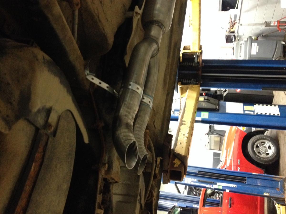

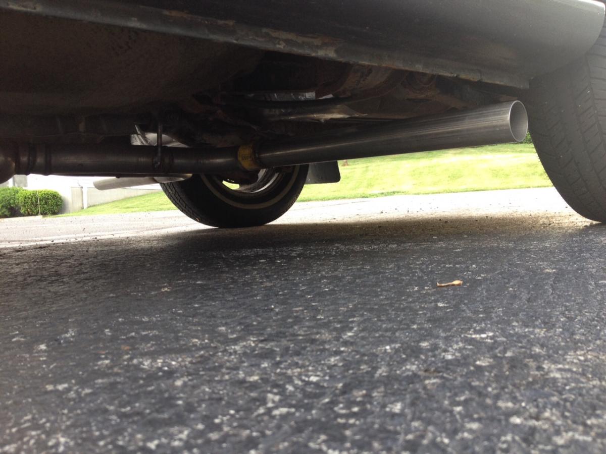

And now the latest modification... Have you ever seen a Subaru with dual side exit exhaust? cold morning steam A little problem caused me to have to run turndowns from a backwards glasspack (baffles dont do anything, its straightpiped) with metal hangars. That sucked for me and everyone in about a 2 mile radius. Again, if you live in the WNY area and have to put up with my noise, I really am sorry. its a little on the loud side... If it sounds like Im tring to blow up the motor by driving flat out everywhere, I am. I love this car but its time to move on to something newer. and quieter. much much quieter...

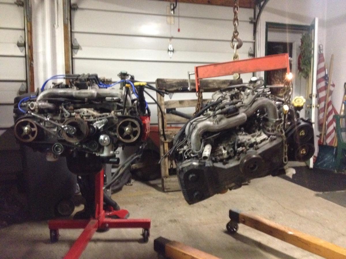

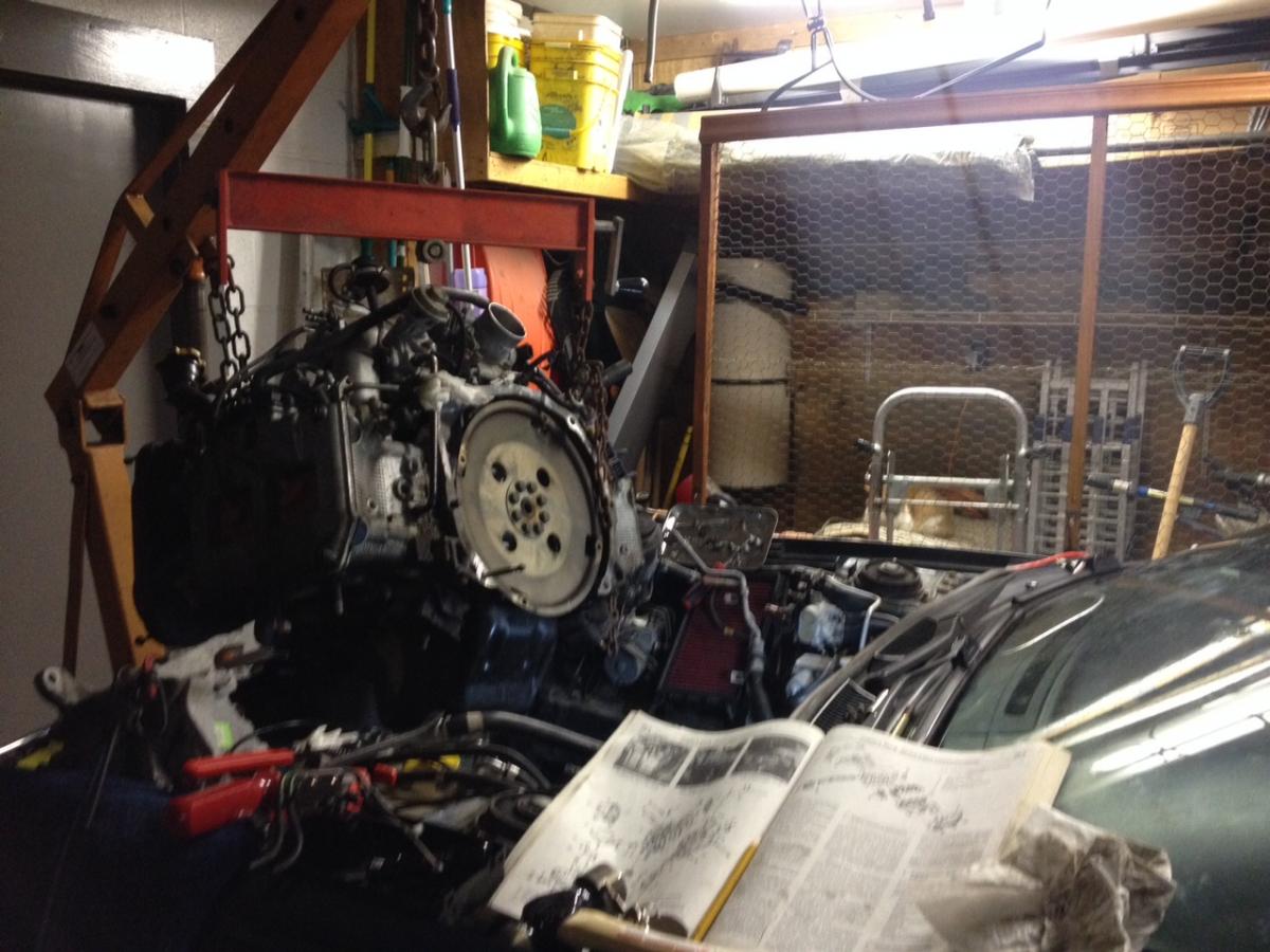

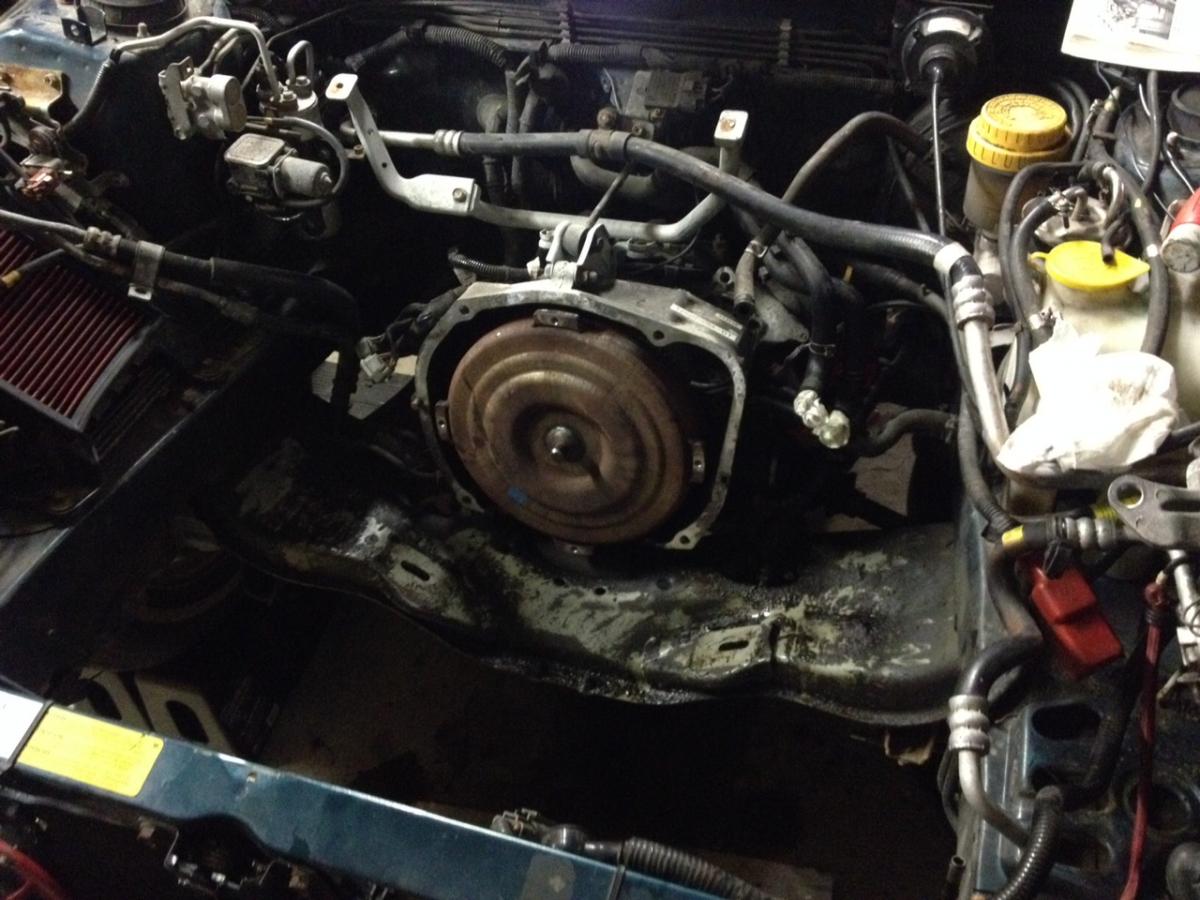

That motors been chugging along just fine, despite some scary noises (excessive valve lash and a wrist pin) its lasted over 6K by now. during teardown on the EJ25D, I discovered the lower oil ring on piston #4 had spun, pushed out the ringland and heavily scoring the cylinder wall. What surprised me is that there was no noticeable lack of compression, and damage like that happens fast. It must have happened as I was pulling it in the garage for the swap!

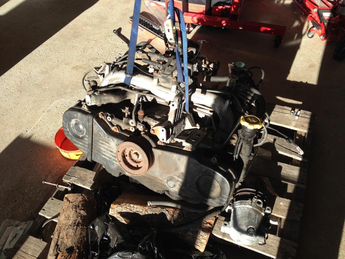

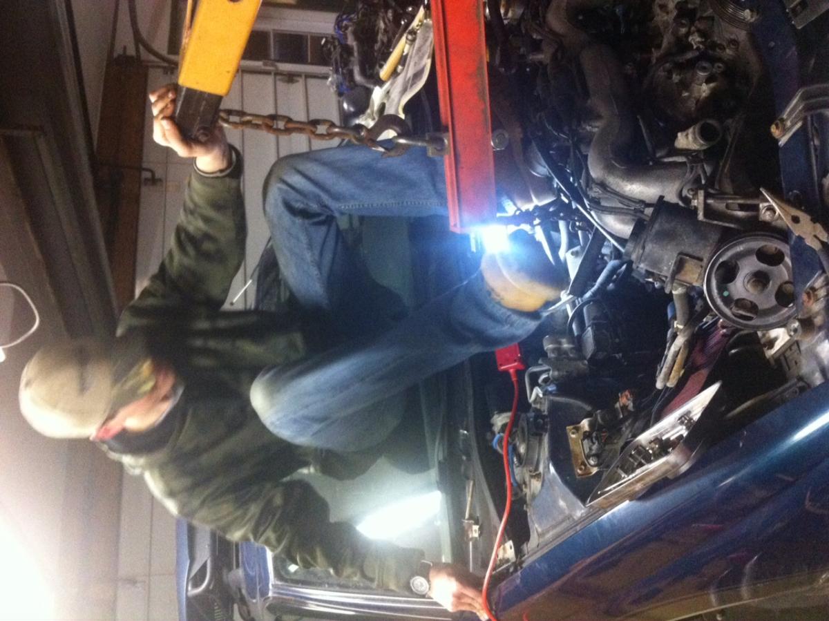

I bought that motor in July (or some time around there) 2014 By december, my car was to the point of overheating every time I drove it. it was swap time. Never having seen that motor run and just going off word of mouth made me nervous, but I had no other options. as a cashier at the local Tops supermarket and a shop intern at a Dodge dealer, I wasnt exactly raking in the cash. so, with the extra manpower from a friend and the help of the wonderful people here on USMB, out came the 25 and in went the 22. have to unseat the dowels somehow... ready to rip! Maiden voyage in a snowstorm. yep, still goes sideways!
Bought an EJ22E from, of all people, the Bishop at my girlfriends church. original intentions were to just tear it down and see how it works, being a gearhead and such pans for it quicky changed as my temp gauge started dancing in typical EJ25D fashion
