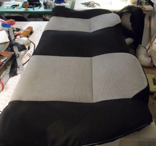

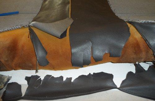

My '93 Impreza seats needed some attention. Since I only paid $600 for the car last week, I suppose I could have gotten some seats from the junkyard~ but I'm really wanting to make it "mine" for as little money as possible and I had the black Cordura on hand~ I reused the center stripe panels from the old seats and the welt to tie it in with the rest of the med. gray interior.Rear struts goin' in tomorrow. Having my mechanic do that. I thought about tackling them since I was successful at doing the timing belt/pulleys/drill/tap/helicoil for the tensioner bolt... :/ but a few people have suggested to just let him do it. Still waiting on the cats for the '99 Sedan which had cats until my son got a "custom exhaust"...97Outback still going strong with over 230,000.

Thanks Tom & ?. A couple weekends I picked up a door for my '99 Sedan and it came off a 97 wagon, so I was hoping for the same luck with Impreza. Had to swap the wire harness and all as the 97 didn't have power door lock switch. I hate those little pastic clippy thingies~ all my black wire ties were passez, so I just anchored with electrical tape. Today, was able to reupholster the back of the back seat for the impreza...starting to breakdown the bottom of the seat. I reused the center stripe accent, reused welt, made new headrest welt out of the old slate vinyl and the black is Cordura
