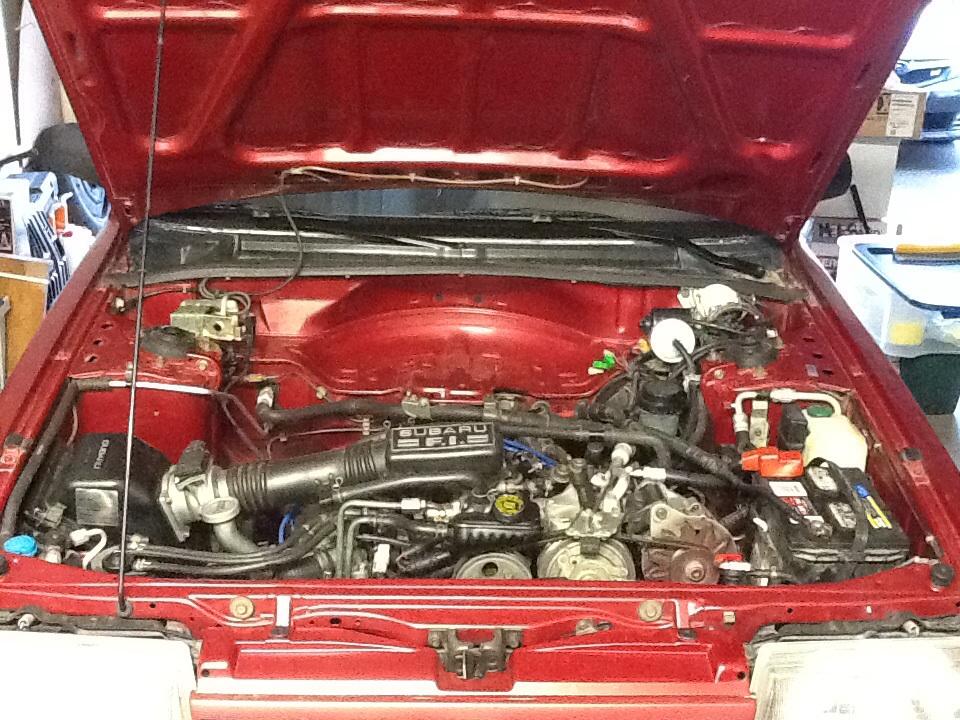

Hmmm, must read on how to post big pics....kinda a newb ...
