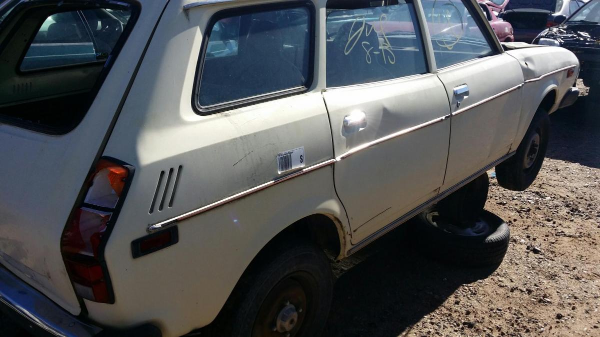

Hey I'm wondering if someone here can help me out before I make a long drive! A usmb member pointed out a '78 wagon at a UPULL which is about 100 miles from me and kindly sent some pictures. For my 78 brat I really need some interior door trim pieces and a window regulator / slides. If it's a 4-door 78 wagon, will the drivers side door be the same dimensions as the brat? Or will I get there and just be mad because everything is close but not actually swappable ... TIA!
