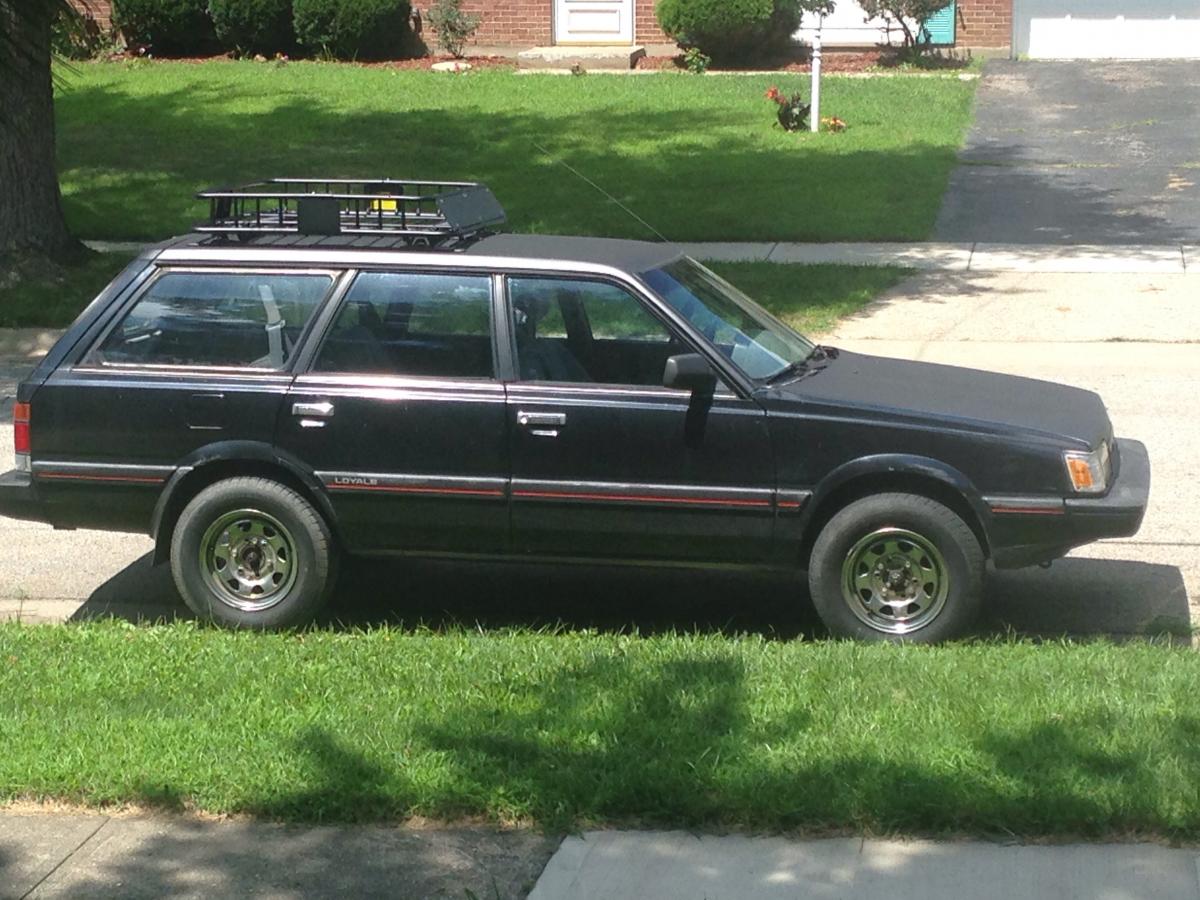

And now the roof rack has arrived and gone on. Still fiddling with a slow brake leak somewhere and the oil leak onto the exhaust, and an exhaust leak at the collector.

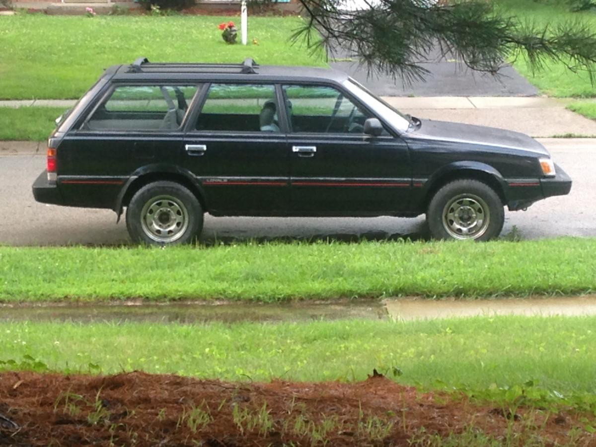

Found some old Nissan P/U wheels and tires for $100 for the wagon! They are 195/75/14s and they fit with no trimming. Way smoother ride and better handling than the 185/75/13s I took off.

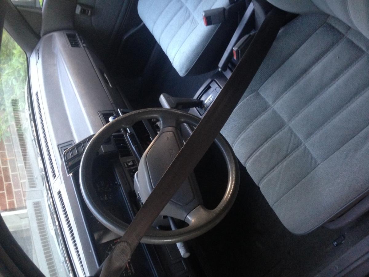

So I found a perfectly good forester 6disc/tape deck factory stereo at the junk yard. I used the cargo tray in front of the shifter as the trim bezel since that stereo is so deep. Not quite finished, but I now have a radio.

I like it, should be a great tinkering project. What size are those tires? Looks like stock 13" steelies but those tires appear huge for a 13 rim.

Thanks Tom, I found it on craigslist in Cincinnati, always wanted an old Subaru, and when I started checking out mods and off road ideas for it your threads were some of the ones that convinced me to buy it. The red stripe on the moulding was my idea, I had some 3/8" red pinstripe in the garage and it fit the moulding perfect. Interesting thought about the short causing the turn signal issue, it does have trailer wiring and the factory hitch so I will follow that and see where it goes. I actually just found the same KYB struts you mentioned on Amazon for $44 each, they are my next purchase. The roof and hood were completely sun-faded all the way to the primer, so I scuffed them and Plastidip sprayed them, turned out better than I expected. The steelies I had to scrub and paint, and I found the centercaps on ebay. I want to find either some 185/80/13 tires, or some 14" Pug steelies. The factory wheels and tires do not look good they are way too small. Future plans would be fog/driving lights, roof rack, maybe a 3.9 LSD rear if I can find one, nothing major just a cool old cruiser that will go anywhere.

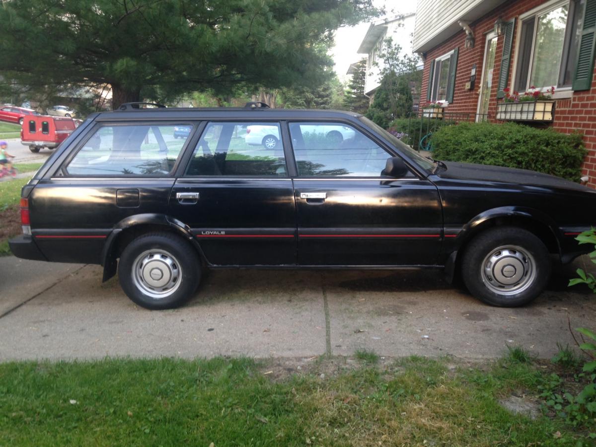

Just picked up a '91 Loyale for $399. replaced the front diff and CV axles, and muffler. Still having a few issues: 1-brake pedal is soft when running, and pumping the brakes at idle causes an engine miss. 2-with the lights on, the left turn signal causes the stop lamp dash light to flash. 3-the temp slider does not change the air temp out of the vents. 4-the windows all roll down from the master switch, but only the drivers window goes up from the same switch. 5-the oil pressure gauge is 15ish pounds at start up, but drops off to below zero when running. Any help with these issues would be much appreciated.
