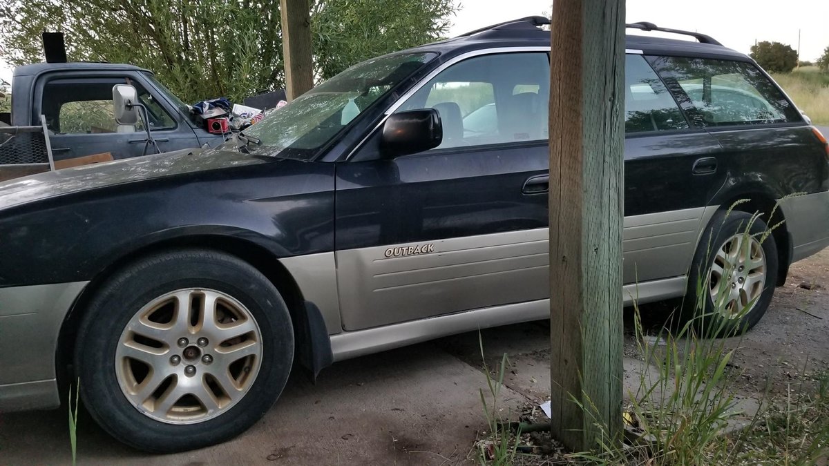

Just picked this up about a week ago. Very little rust, though that's not too surprising in this area. Bought new in Utah by the original owner, and I picked it up in trade. Runs amazing for a high mileage car. No knocks, no shakes, no smoke, no leaks! Interior has a couple rough spots, rip along the seam in the drivers seat, and a cut in the headliner adjacent to the sunroof motor. Sunroof switch didn't work so I assume it's for direct access to the wiring to make it work. Currently undergoing an entertainment system upgrade, adding navigation, cellular and internet access onboard with touchscreen in the dash. Planned upgrades include lift, some power mods while remaining NA, and a few lighting and cargo capacity upgrades for off road adventures.
Haven't been active in quite a while, for I've been out of the Subaru game (almost for good). Traded an old clapped out 93 ranger for a 2000 Outback Limited with the 5 speed and already running into problems. I was aware upon the trade that these problems may surface though. Here's the deal. VERY high miles - 353xxx. Engine runs perfectly, throws no codes, etc. Transmission has no 4th gear, originally figured shift bushings being an issue like it would have been on the older models. Went to back up the other day, foot slipped off the clutch and "BANG", transmission popped loudly and shook the entire car in doing so. Now it sounds as if something is grinding in there, while in motion in any of the remaining gears at any speed or engine load. Pulled the dipstick and definitely some tiny metal flakes and sheen to the oil. So it's pretty obvious that it'll need to be pulled, either to repair or replace. My question is - does the engine have to be removed in order to drop the transmission, or is it much like the older EA chassis where it can be pulled without yanking everything? Another question, is the 6 speed a bolt in option in these? Apologies if this has all been covered before, would appreciate a point in the right direction if so. Thanks!
