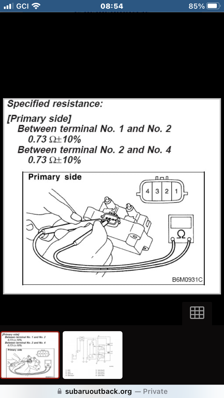

I only went to the other terminals because I got a new multimeter and was curious. I started with what was in the diagram and then proceeded to probe around out of curiosity. The image above specifies 0.73ohm, and I am getting 80ohms across the above pins and NOTHING else. Compression checks out across all cylinders. All between 183-189. Plug on cylinder 2 was soaked in fuel…couple this with the lightning storm that came off the end of the lead when unplugged and the fact that the engine doesn’t run any worse when I pull that particular lead off and I want to believe it’s not the coil but maybe it’s just not pushing the required voltage and amperage anymore edit- prove to probe
No codes. Just rough idle and lack of power. Sometimes it runs fine, for a bit. Then rough idle and no power. Now when I unplug cylinder 2 when running rough the boot end is shooting sparks everywhere but the engine doesn’t change. If I unplug 1,3 or 4 it bogs down. I swapped plugs, NGK copper. NGK wires. The coil is an OEM coil. I’ve changed the fuel pump, fuel filter, plugs, wires, alternator, cleaned IACV, MAF, ran down the vacuum lines. Have strong fuel pressure on engine side of filter. Strong smell of gas in exhaust when it runs rough. Have O2 sensor and new IACV on the way but I feel like this isn’t it, car has unknown miles so these parts don’t hurt my feelings too bad that I’m shotgunning parts at it. Checking compression on #2 next.
Testing 4 pin coil on 1999 Legacy L 30th Anniv, 2.2. Using the pin number assignments in the photo, on the 4 pin primary the ONLY resistance I can pick up is 80ohm between pins 1&3 and 3&4. On the secondary I am reading a hair over 10k. These are a far cry from any spec I’m seeing in any service manual. No visible damage, smells or otherwise. Is this coil junk?
