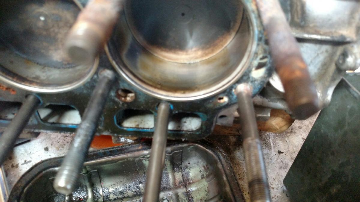

Hey Dave, thanks for the reply. I live in New Mexico, so there is definitely a lack of humidity. The cylinder wall looks pretty clean, and the top of the piston has some black soot, but no corrosion. I could post a photo but I am not sure how to do that. -
I just bought a cheap spare motor for my 1980 Brat. It is an EA71 from 79, and the owner claims it was in a running vehicle years ago, and that it has low mileage (50k). When I got it home, I hooked a compression gauge to all cylinders and hand cranked the motor, no compression reading on the number 4 cylinder. I decided at that point to remove the head, and what I found was a lot of rust on the bolts that hold the head on, and the intake valve and seat chewed up with giant gaps. My question is, is it possible that this corrosion happened while the engine sat? Should I get the valve job done and use this motor, or assume that it is actually high mileage and forget about it. Any ideas or discussion are greatly appreciated, I am kind of at a lose on what I should do.
I am the proud new owner of a 1980 Brat. I found that the compression on the number 4 cylinder reads at 120, the number 2 at 140, and the 1 and 3 at 135. This seemed like. Pretty worn motor, lacks power so I picked up a low mileage ea71 from a salvage yard. When I check the compression by hand cranking the motor (off the vehicle) I get 30 psi from all cylinders, except a 0 reading from the number 4. Does anyone have recommendations on what could be the cause, and how I should check and or fix before installing this motor? It has sat for 20 years on a shelf (hence the low mileage). Any thoughts or ideas are greatly appreciated, I love this forum!!!
