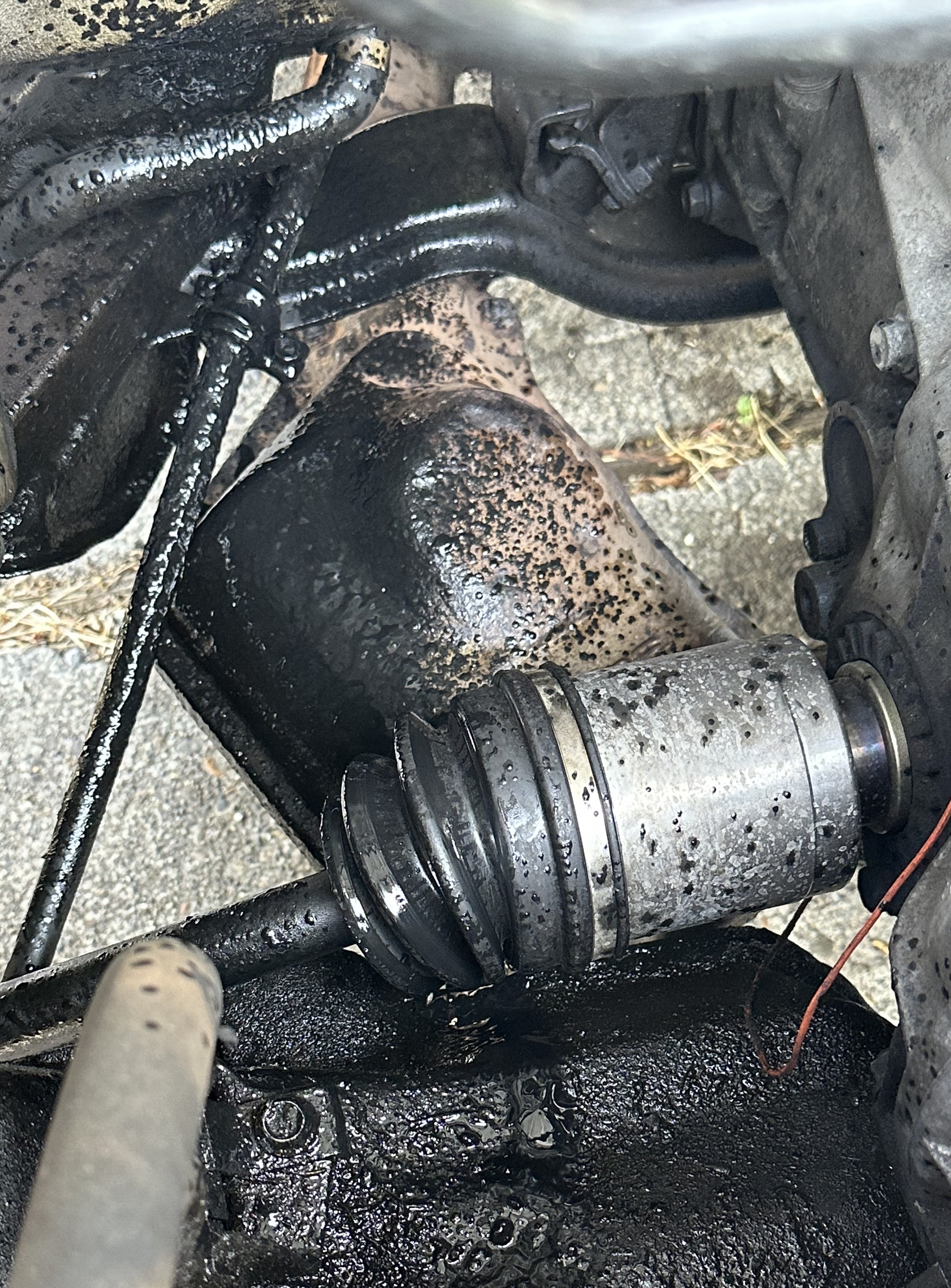

Thanks all! 100% ended up being grease from the cv boot. I couldnt notice any cracks but did a deeper dive and thats for sure the culprit. Gonna dive into it later this week. Thanks for the quick follow up and help again everyone. The subaru car community is the best.
Hey guys. During my drive home yesterday I noticed some smoke coming from under the hood. Looks like something is spitting oil/grease all over my exhaust and axle on the passenger side of my engine. I took some pictures. I cant seem to figure out where its coming from. The engine doesn't appear to be low on oil at all. The valve cover gasket doesn't appear to be leaking. The engine is pretty dry and clean everywhere aside from that big mess. Any help is appreciated. Thank you all
