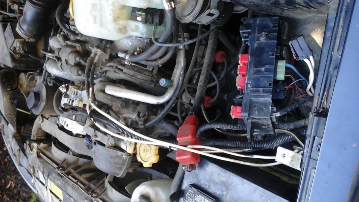

So took off the wheel panel that protects the wires from getting muddy and found a big bundle of all sorts of wires. I didn't really want to take it apart because I didn't know if I could get it back together again but I couldn't be 100 percent sure that the two white wires that go into the fuse box were the same white wires to the alternator. So I unplugged the wires from the fuse box and tried to do a volt test by connecting the wires from the alternator to the battery. I thought it would be an incomplete circuit and not do anything because it was unplugged at the other end but it did complete the circuit. So is there a portion of the wire that is bare in the bundle of wires that is above the wheel that I can't see? Or is the circuit complete even if it's unplugged? Or are those two white wires that connect to the fuse box not actually what I

There have always been two wires since I bought the car but that also doesn't mean that it is the way it's supposed to be. Any idea what gage that wire is? It looks like 12 or 14 gage to me. There is an aftermarket cd player in the car and I have always suspected that the speakers are aftermarket because they are too good to be 21 years old. So it could be just slightly too much current going through those wires. We will see when I switch them out for bigger wires. Thanks for the help!

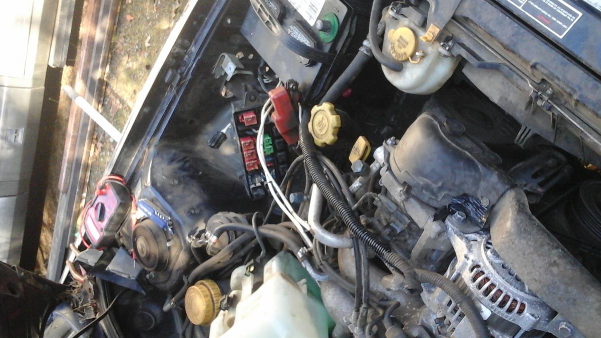

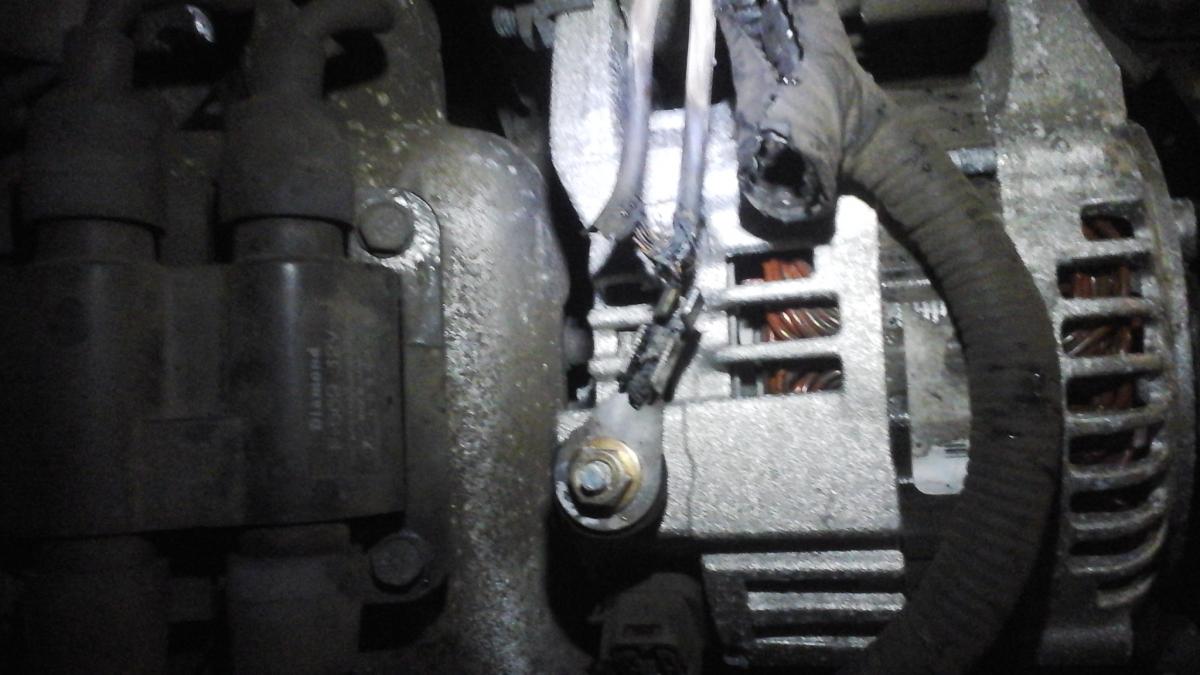

Okay, so I'm driving home in my 96 legacy and see my speedometer and tachometer drop to zero then when I step on the gas it comes back. Then the radio goes out. So I recognize the symptoms of a dead battery. Get to the top of the driveway and the car dies. I'm pretty sure I know what I'm going to find under the hood because This is the third time in 1.5 years that this has happened. I haven't ever figured out where that wire goes but I'm assuming it goes to the battery because it's connected to the alternator. The wire gets fried like that about every 6 months then I re-attach it and it's fine until it gets hot and fries itself again. I thought maybe it was a bad alternator but the last time I took it out and got it tested and it was fine. I'm thinking there is a deeper problem here though. Some thing is overpowering that wire(obviously) maybe someone here would know what's going on. And why is it so regular. Regular to the point that last week I checked the wire to see if I could tell if it was going bad. I couldn't tell anything so I just kept driving and now it happened again. I don't remember the check engine light going on the other times, maybe I didn't check the codes and maybe it was never on in the first place but this time it is on and so I checked the codes and I'm getting po500: the speed sensor is at fault Po135: the bank 1 O2 sensor 1 oxygen sensor heater circuit Po180: the bank 1 O2 sensor 2 oxygen sensor heater circuit I haven't done any research on what the last two are so I have no idea what that means but I guess it makes sense that this problem has to do with a heater circuit. Any ideas on how to figure out what's up with my subaru?

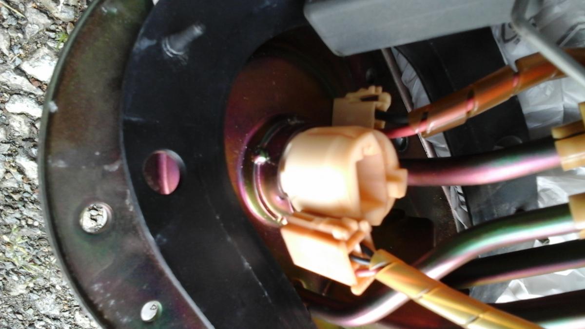

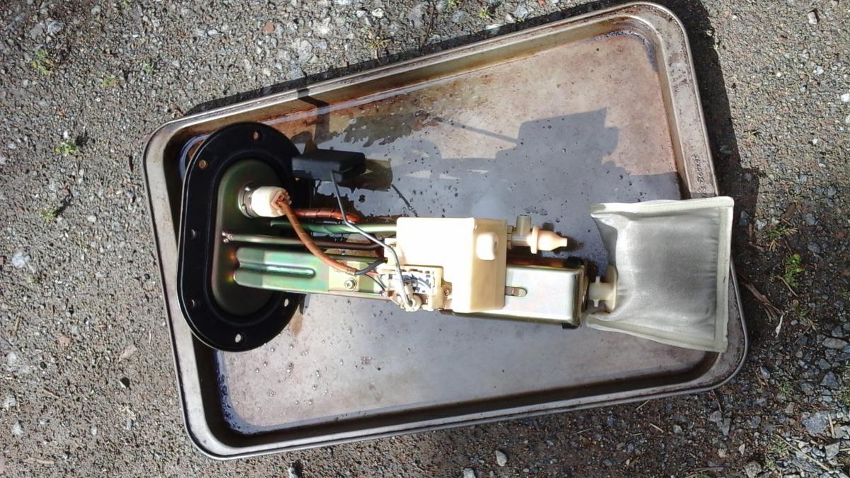

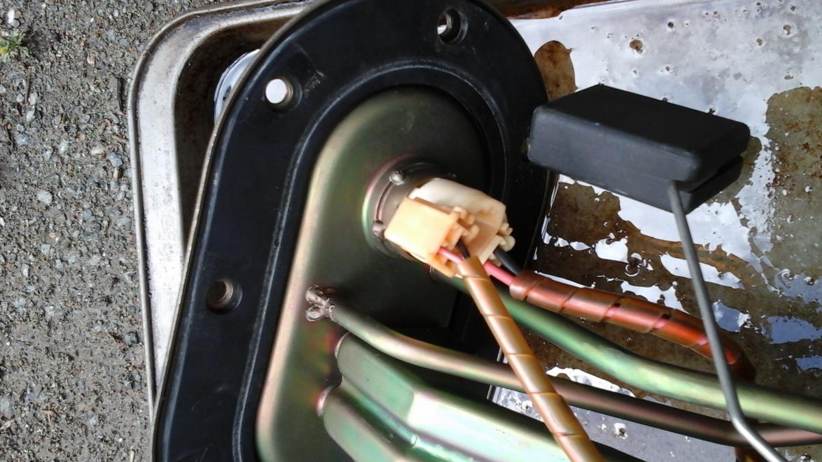

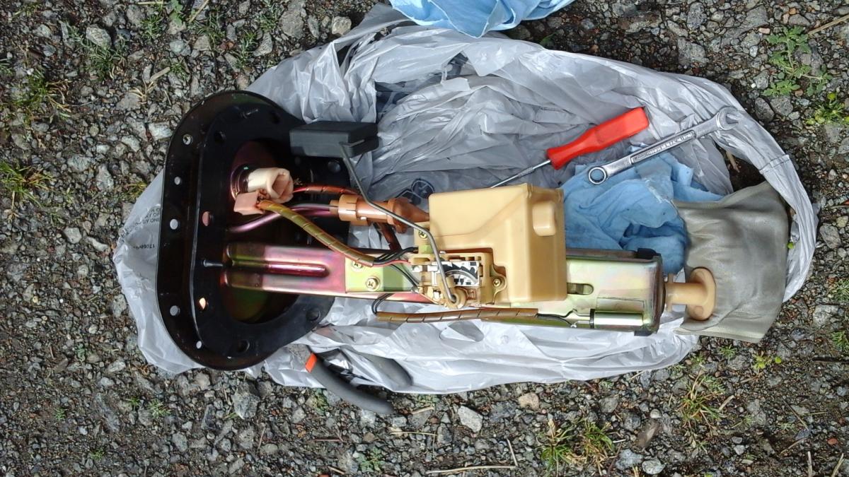

I basically did that and now my car works. Here are some pictures for any body who has the same problem as me. The pump I salvaged didn't have a fuel temperature sensor and so was missing a wire in the connection that attaches the fuel temperature sensor plug to the assembly plug. So what I did was swap the pump from the new assembly to the old one. If you end up salvaging a part, look very carefully for differences. That's the lesson I learned. I thought I was in the clear because I got my new pump off almost exactly the same 96 Subaru Legacy but it was the model that had the Ej25 engine while my Subie has the ej22. Now that I know it makes perfect sense. Old one: See the little metal cylinder at the bottom of the assembly? That's the fuel temp sensor. See how there are 4 wires in the plug? New one: See the difference at the bottom? No fuel sensor and only 3 wires (it looks like 2 in the picture but the third one is hiding) I hope this helps someone.
