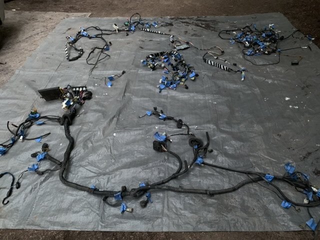

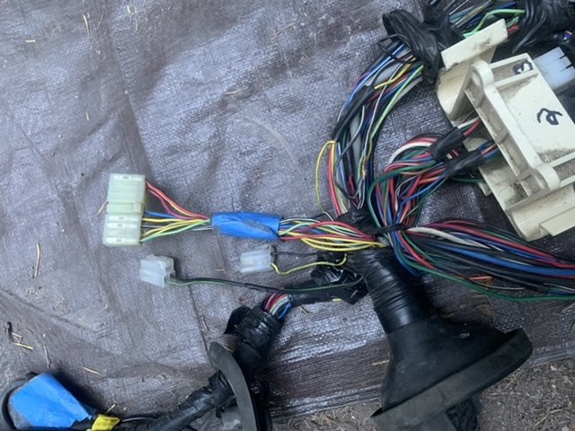

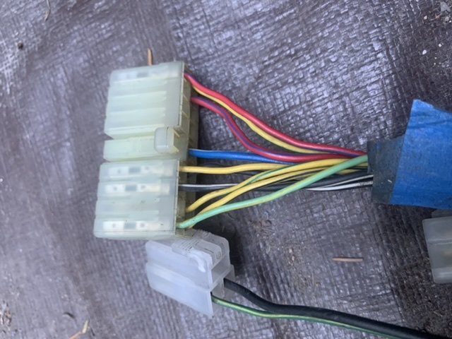

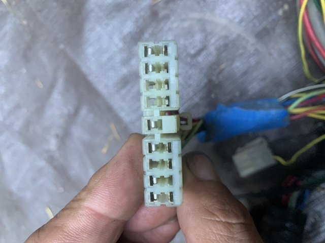

Thank you, that makes total sense! He traced each wire and they all went to different systems, we didn’t consider diagnostics. -

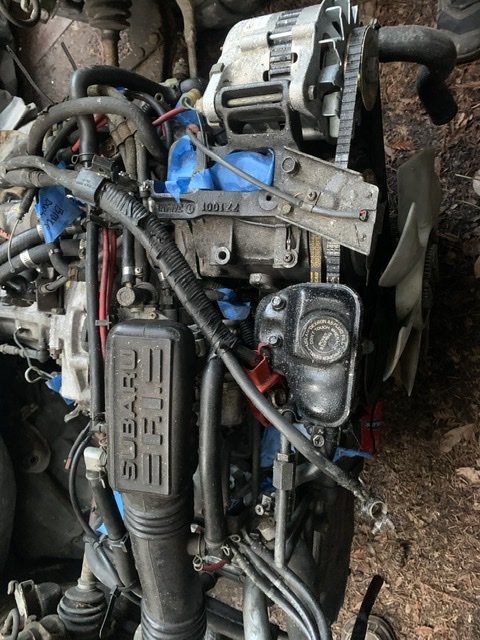

This is the last plug he is working with. The original harness in the car doesn’t have the corresponding plug, tracing each wire now. Any input is appreciated! -

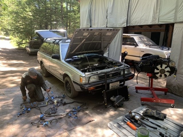

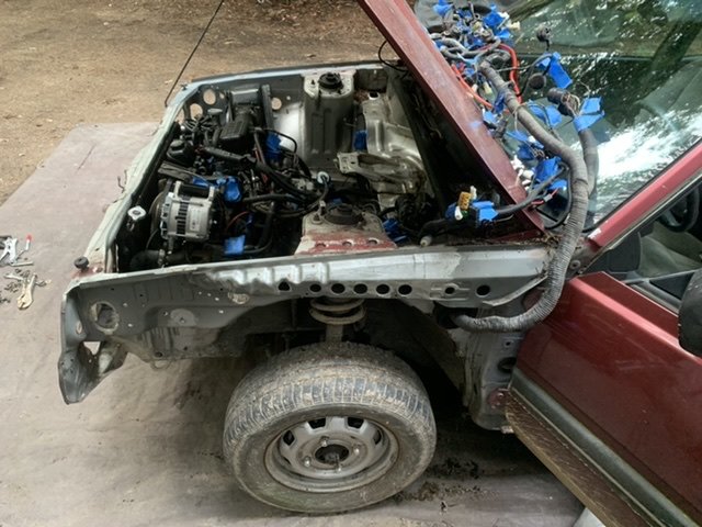

Let the swap begin! My son decided to swap the entire loom. He has every single connection identified and labeled on both ends of both the old and the new harness as well as all of the other mechanical bits. Thanks for the advice. -

Hello, Today’s question: What is the best approach when it comes to the wiring? Do we thin existing spfi harness and overlay old harness or do we splice necessary new wiring into old harness. It looks like most everything is the same except for the distributor/coil wiring and the fuel injection wiring. What else should I be aware of? -

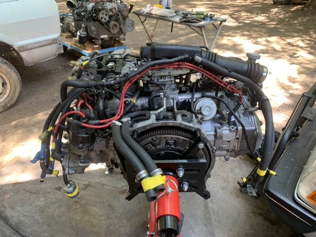

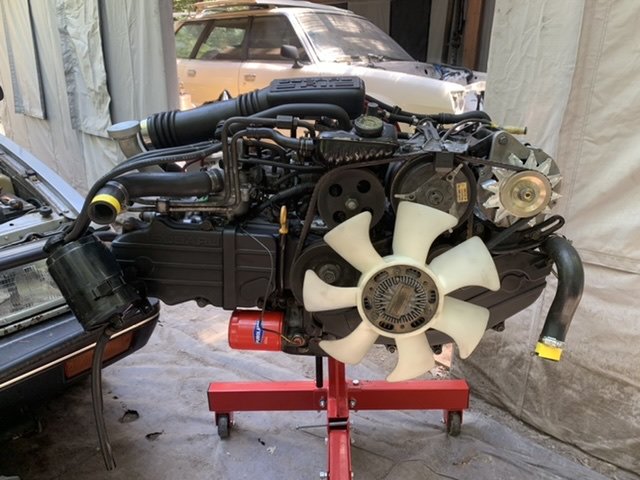

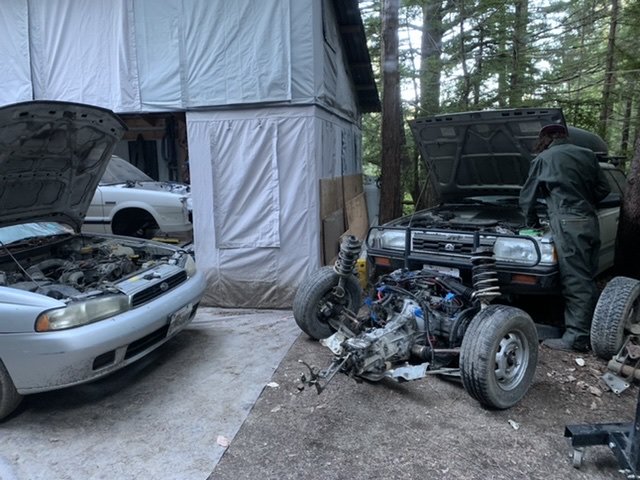

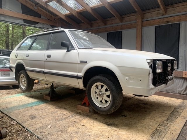

Hello again, I have everything setup to start removing all necessary equipment from the 96 Legacy donor vehicle in the morning. This is the 2.2 that will be rebuilt and installed in the 82 wagon. I’m planning on utilizing all factory emissions equipment to meet California smog requirements, with that said, I’m planning on hauling Legacy body away before swap is complete and I want to make sure that I harvest all necessary equipment before it’s gone. I’m planning on removing entire harness from ECU out, engine, all emissions under hood, fuel pump...Is there anything that I am likely miss?
Greetings, I’m curious as to what would be the best wheel/tire combo for my 82 wagon with a 4” lift. First of all let me say that I’m terribly sad to be departing with the looks of my 13” wagon wheels, with that said, I’d like to find a set of 6 bolt steelies with the tallest tires that I can fit without ANY body modifications. Your input on what wheel type, offset, tire size will work without rubbing is greatly appreciated. Thanks

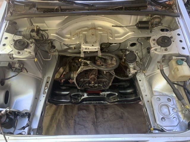

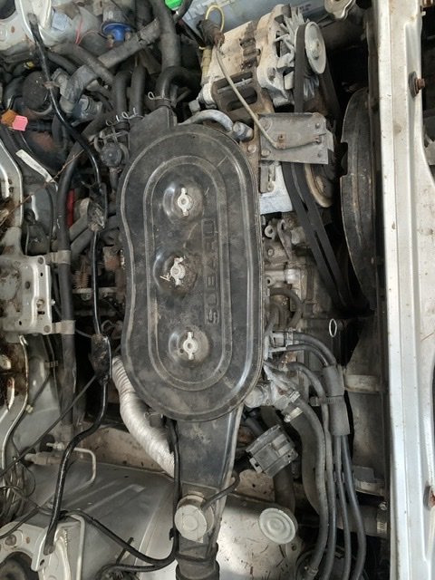

I’m planning on moving the battery to the left side to make room for the air cleaner from the 2.2. Everything on the donor vehicle is on the opposite side so I figured it will be easiest to keep things in similar positions. Seeing as how I live in CA and plan on this to be a smoggable swap, I am required to carryover the entire emissions system as well, a clean slate makes it easiest. As far as the wiring is concerned, I am thinking of taking all of the body side wiring (lights, horn, temp, ect..) outside of frame rails. I’m thinking of a more radical solution for the engine wiring.... I’m thinking of relocating ALL engine bay wiring and electrical components to the “spare tire shelf” and fabricating a custom cover that will enclose from shelf edge up to cowling allowing for all engine wiring to feed from rear center of engine bay while all other body side wiring is tucked out of sight. I plan on waterproofing entire harness as I go so there shouldn’t be any water infiltration issues.
