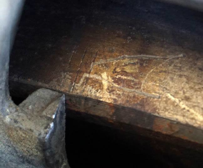

I'm the ... fourth owner, so I don't know who painted the flywheel. I did assume after I realized this wasn't for the timing, that it was for a reinstalled distributor. That's when I learned that the distributor is connected mechanically to the camshaft and couldn't normally get out of time. Decided to leave the covers on until I do a rebuild later in the summer; there's just too many fluids being flung around, so I don't want to potentially degrade the new belts. Now that I know how to do it, I don't mind. I did keep the fan shroud off, I don't really see a reason to have it on there. I wish I could change the title of this thread to "Timing Belt Replacement Instructions," so the next person that's looking can find it easier. Or, make them work for it. Thanks again, to everyone for helping me. -

I may have found my problem. In the video it talks about some painted marks on the flywheel. On the video, the painted marks are on the three vertical lines. On my flywheel, the one painted mark is not. I aligned my 12/6 with the painted mark, but I think I should have aligned it with the middle of 3 vertical lines. Is that right? -

I did the procedure, consistent with what you wrote, with the video, and consistent with my haynes manual, and verified with a mirror (I am working with engine in the car), that they are 180 degrees from each other 12/6 with painted flywheel mark at top. Tightened the tensioner pulleys, etc. Instead of putting everything together, I wanted to see if it would start without reinstalling all the v belts/accessories just to see if the timing is right to fire it up. The engine turns but never fires, and I can smell the fuel reaching the injector. Am I supposed to put all the accessories back on for her to start even for one second? -
