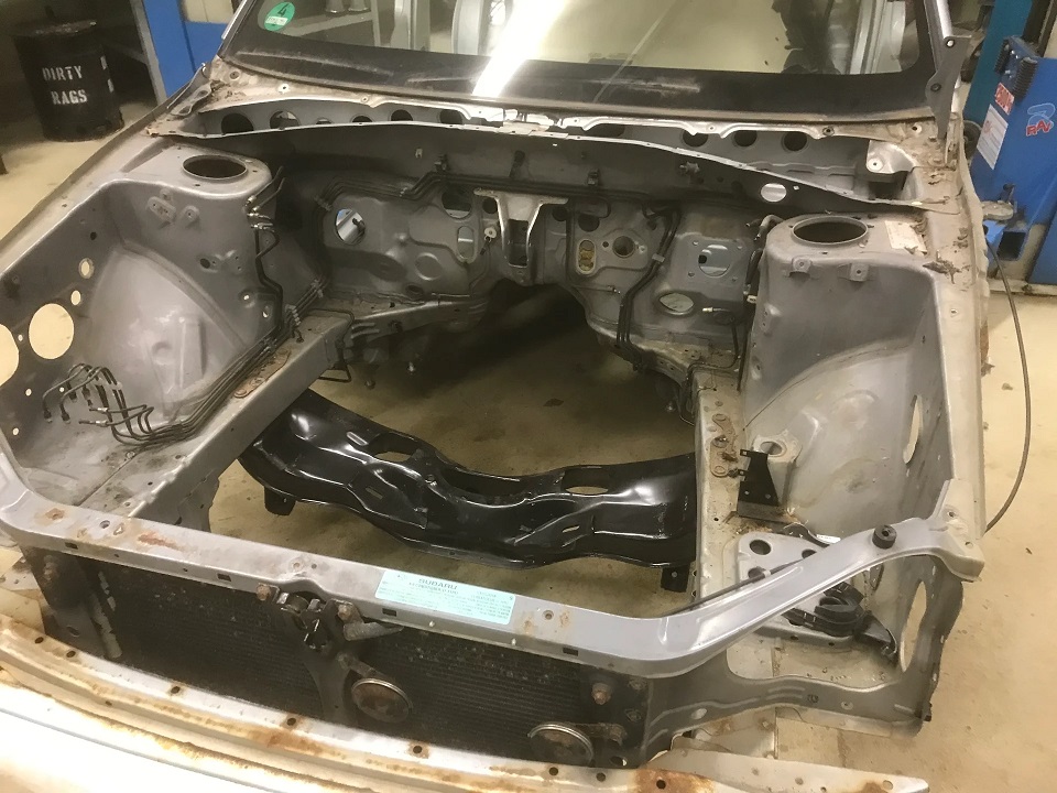

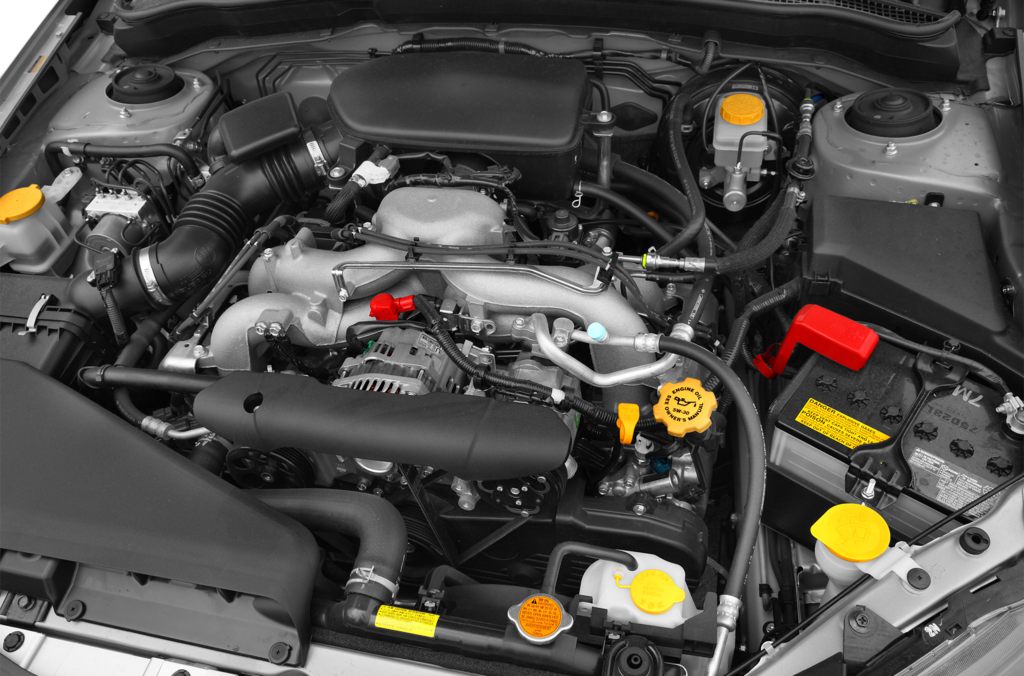

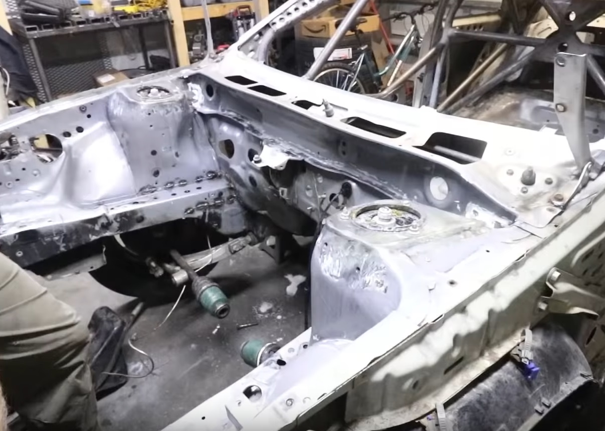

One of the subtle changes Subaru made from the first through third gen Imprezas was tying in the strut towers to the cowl/firewall. First gen Impreza: 2nd gen Impreza: Couldn't find a good pic of a 3rd gen Impreza engine bay, so here's a bad pic instead: It may be worth welding in some sheet metal as a brace there so you add support to both sides of the strut towers. Would be worth doing while the engine is out; just have to avoid the fuel and brake lines that run through there. -
