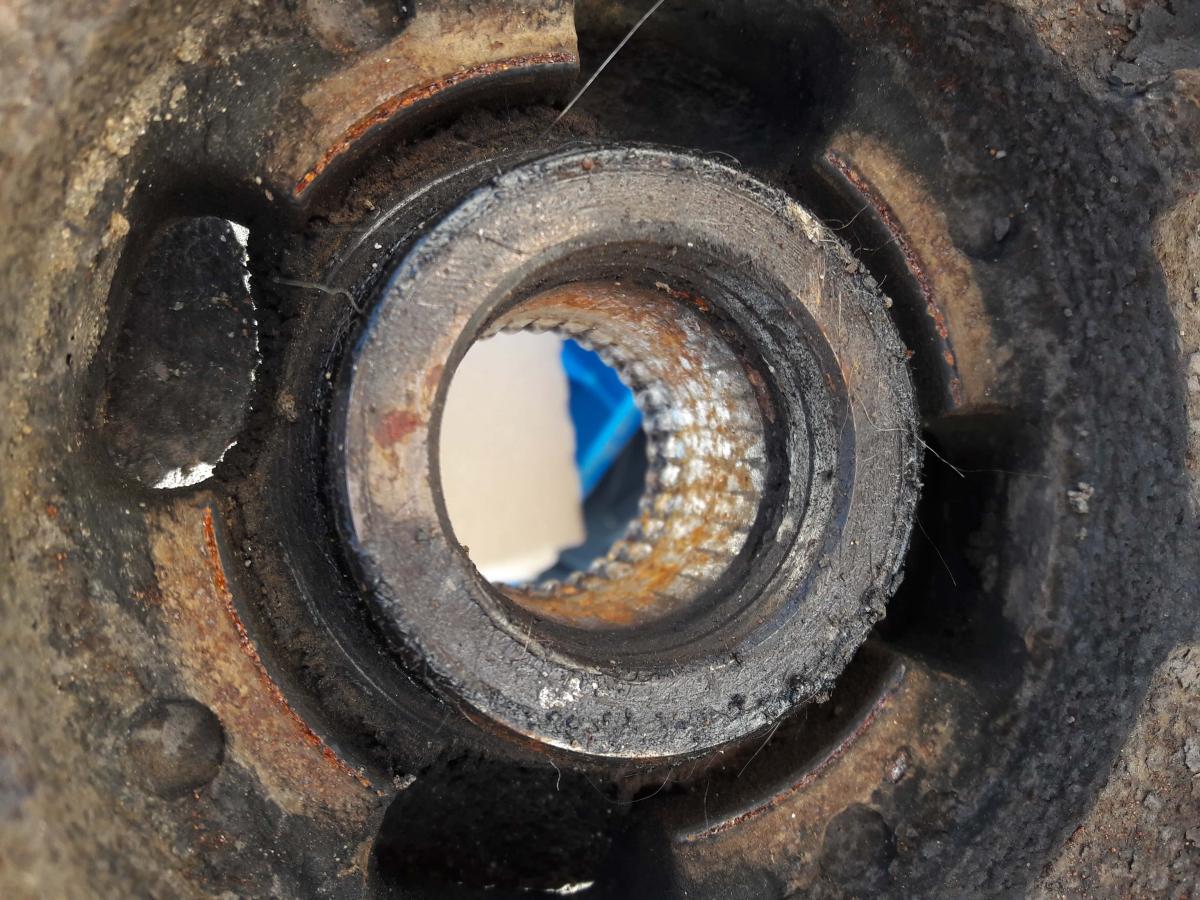

Hi, I need to replace one of my Wagon's wheel hub, the problem is that were I live Subarus in Junkyards are pretty rare, theres only one Gl wagon left that I am aware off with almost no parts. Do you know if another model of subaru or another car uses the same hub as in the GL. I know of a 1981 EA81 DL left in another junkyard and it is pretty much complete, but I dont know if the hubs are compatible. I cant really afford a brand new hub right now. :/
