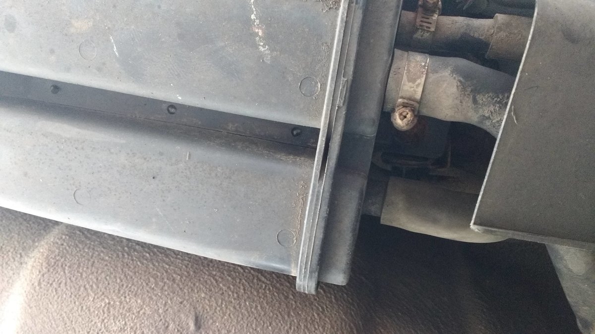

1. The fuel filter neck/gas tank vent valve needs replaced. My thoughts with this is that the venting valve is not properly functioning
2. The carbon filter or tubing leading to the carbon filter is blocked.
