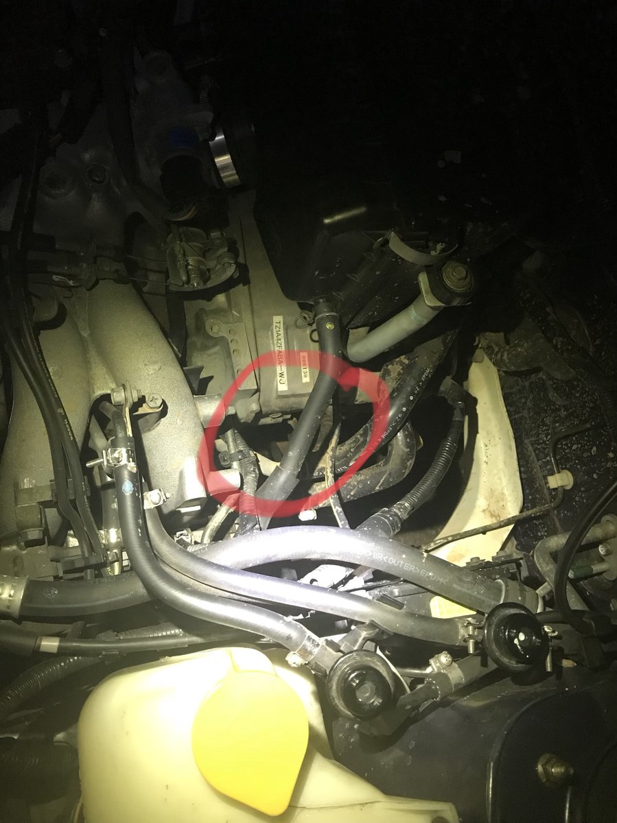

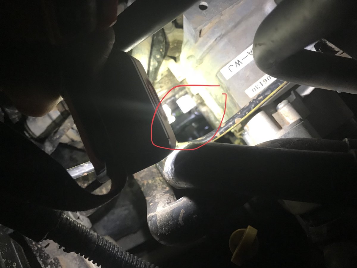

Checking under the hood of my 2002 Subaru Outback 2.5 i noticed a very small amount of coolant that looks to be dripping from the heads and catching on some sort of dish just above the power steering rack. I also noticed some fluid leaking off of my power steering rack, it looks to be oil and im concerned it is leaking from above onto the rack somewhere close to where the coolant has been leaking. My power steering fluid resovior is still at the same cold full mark when i purchased the car 3 months ago. The leak looks very small and i can only really notice it leaking when the engine is running. And after a long drive when opening the hood i can see some sort of fluid dripping onto the exhast and burning off. I only notice the odd drip of coolant not 100% sure if its coming from the heads or something else, but from what i have seen online so far it doesnt look to good and i am fearing for the worst. I should also add that in the time i have noticed this leak when starting from a cold start it makes a abnormal noise hard to explain. From what i have read online this may be the engine missfiring on startup, due to low compression from the head gasket leak, could this be possible even with the smallest leak in the head gasket? does this sound likely? The sound does not occur when starting the engine once its been warmed up. I have included some pictures but it is hard to see the small puddle of coolant. I have a few questions. If i have to go about doing this repair what other things should i fix at the same time to give this car atleast another 100,000kms of life? My coolant is bright green with no signs of any oil and my oil looks great with no signs of coolant. Are these the first signs of a failing head gasket? how many hours of labour should i expect to be charged if so? Car has 173,000km
