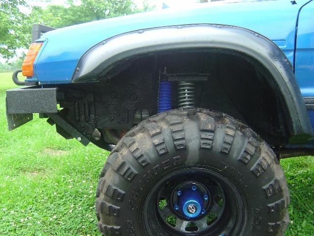

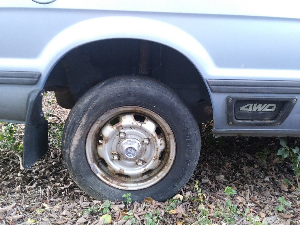

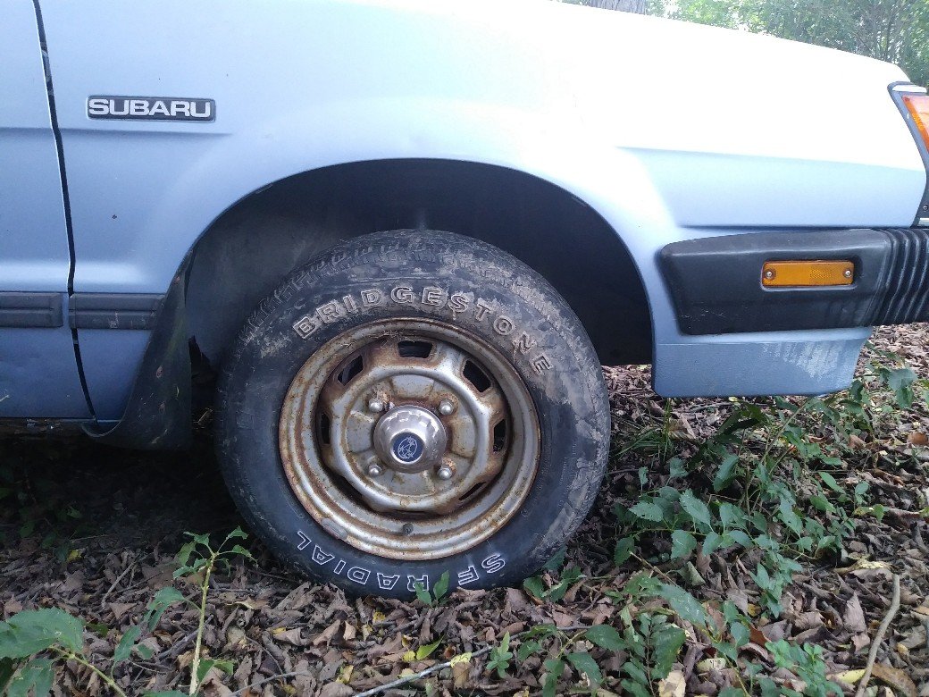

Here are what my fenders look like now. I would patch the step hole and build a bumper similar to the one above. -
So it looks like I am going the 5MT/EJ22 route on my BRAT. Between the low gearing and higher output, I understand tire spin might be an issue in wet conditions. I would like to install larger tires to alleviate the issue, but I don't really want to do a lift. It's kind of a shame because of how nice the body is, but I also kinda like the way the 1980s Toyota flares look. My question is, does anyone know what tire sizes are possible with these flares but no lift? The extra ground clearance is also attractive, though I don't really plan on doing any serious offloading.
